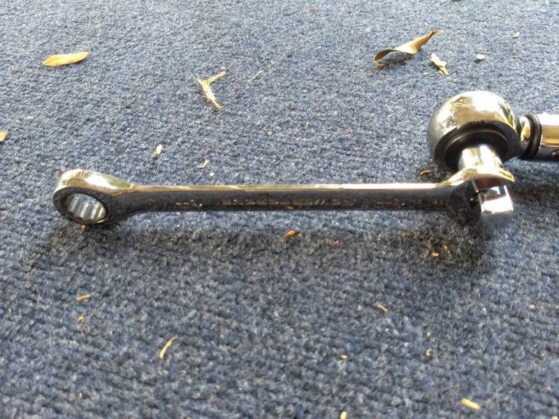

      This is how I torqued my upper rear drivers side control arm. Ratcheting 15mm wrench, 3/8 drive reversible torque wrench with a 3/8 to 1/2 drive adapter, and the formula from post #4.

      Thanks Jerry. I'll dig back into the rear bolts again. I can't recall if it was on the ground. I'd bet I had the wheel off which of course means no. That piping is definitely from the UC.
