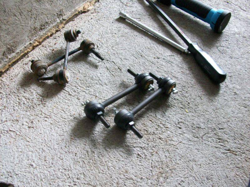

Pictures of rear links

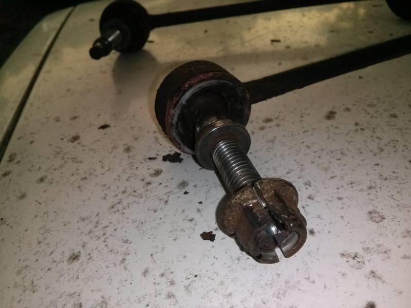

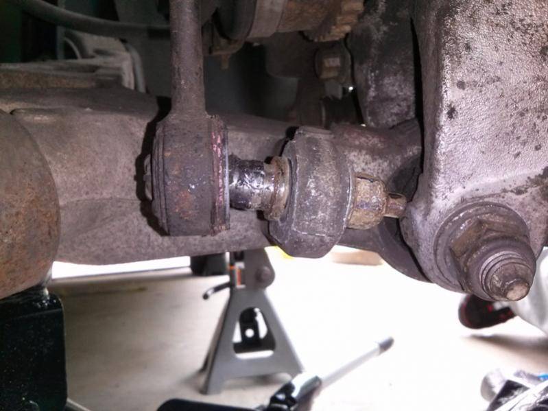

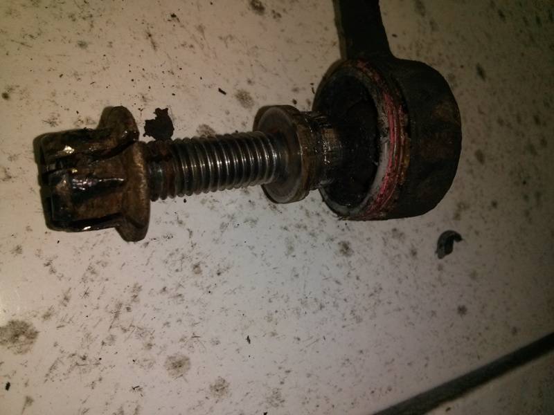

I did this same repair over the course of a month I started with the rear and then moved to the front I actually got my parts on Rockauto and I used a Moog part that was exactly like the parts pictured above for the front, I paid about $30 for the pair and shipping for the front . I had a horrible hollow knocking noise in the front when I hit small bumps or driving on a rough road it was very loud and could be heard as I drove by and it could be heard on the inside as well. I could even feel it through the gas and brake pedals slightly. I had already replaced the top control arms and lower ball bearings on each side and I thought that fixed the problem but turns out it was the front stabilizer bar links or bushings i think is the other term. They are kinda tough to get off because the ball joint spins when taking them off especially the OEM part and lack of space so I had to use a rotary tool to cut the ones off the back and one on the front. The easy way is to start taking them off and once the nut gets tight and no longer wants to move, take a pair of locking pliers and hold it down on one side and then use the rotary cutting tool to the stud off on the bolt side, save yourself some energy and muscle and it shortens the time for this project, just be sure not to cut anything other than the bar links that your replacing. Also after I placed the car on my jack stands I used my floor jack to lift up the support to relief any tension so that the links were easier to remove. Thats how my repair went on this particular issue hope this helps. Do not use a cutting tool on wet parts sprayed with any loosening chemicals due to risk of fire and the sparks from the cutting tool if so wipe it all up before using cutting tool just another helpful tip.
