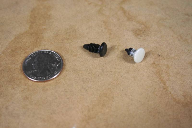

Following up on Jim's post, my 06 LS came with the bracket already mounted. I didn't like it, so I removed it and got a few "automotive body panel fasteners" at the local hardware store to fill the holes. IIRC, I got 3/16th and 1/4 inch sizes. I had some leftover touchup paint and clearcoat from my satellite antenna painting project, so I used that to paint the heads. I'm very pleased with the outcome.
The plastic fasteners are really cheap -- less than a dime each, so get a few sizes and use whichever works in your holes.

I basically copied the idea from Bumperplugs (www.bumperplugs.com). They never show you the actual unmounted product, but it is actually just a painted body panel fastener just like the ones you see all over the LS!
I said to myself, gee, I can make these myself! And I did!

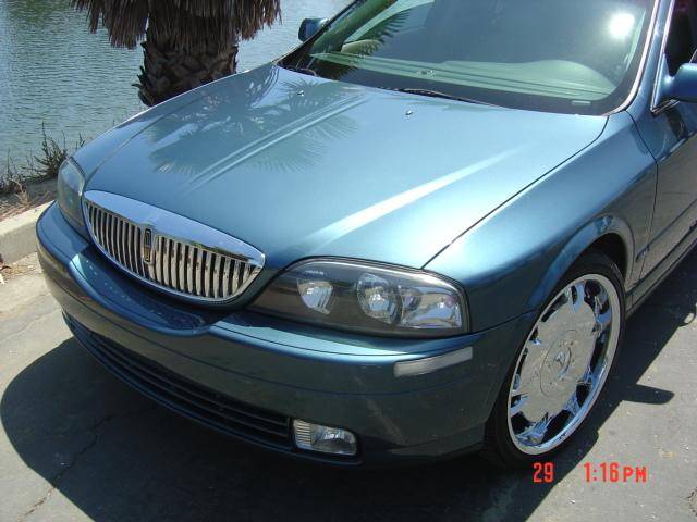

i rigged up some plugs similar since i removed the bracket i painted them with the same color touch up paint from ford. they don't look as nice, i got them from ace just got some little plastic rivit things. i can't show a pic cuz its too big. theres one on the cardomain ,but toddyg whered u get body panel fastners? since i just got my car i cannot get rid of the grime that has built up haha i need some good carwash sh!t what kinds good?

As I mentioned in my post above, I got the fasteners at the local hardware store. Mine was an Ace Hardware store, but any good hardware store with an extensive fastener department is likely to have them.

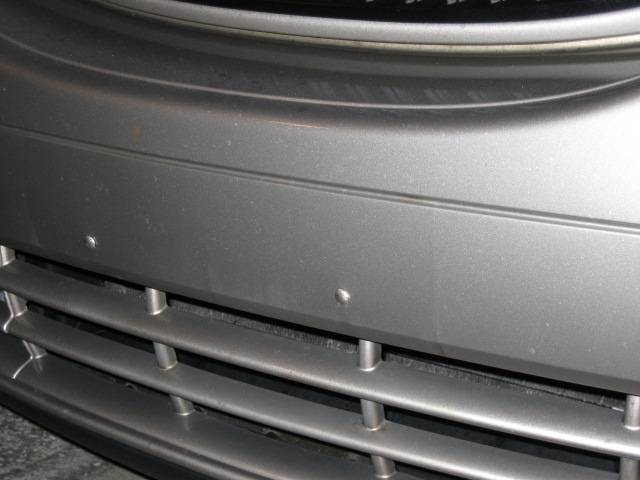

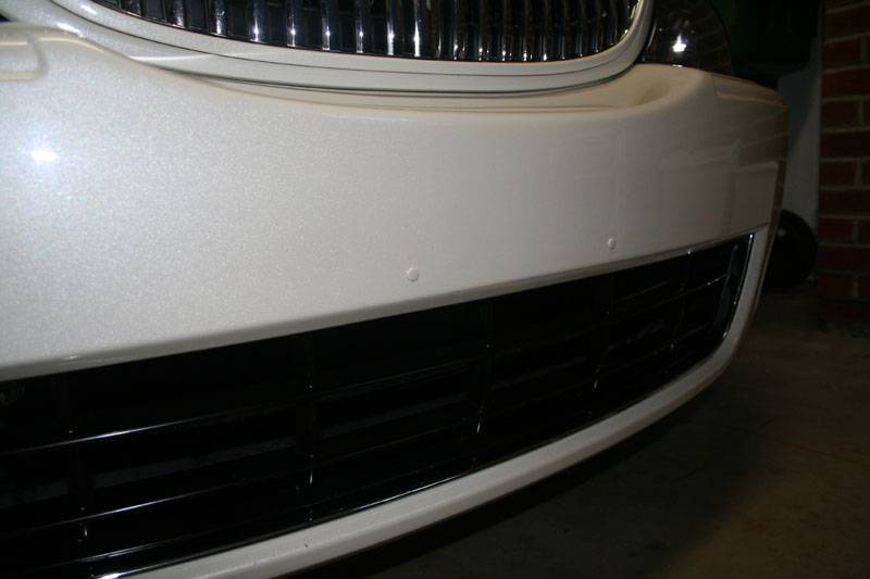

BTW, this is what mine has ended up looking like. I thought I posted a before and after.
Thanks. The damned thing had been on there since the car was manufactured, and there is still some "grime" that I can not get off. You can see it best in the second pic. Does anyone know what to use? My car wash combination is some Meguiars Car Wash and Conditioner and some water, and then some Spray On Wax as You Dry Turtle Wax and a Absorber shammy. I've washed my car a ton and put plenty of elbow grease in to it. Can't seem to get it clean.
