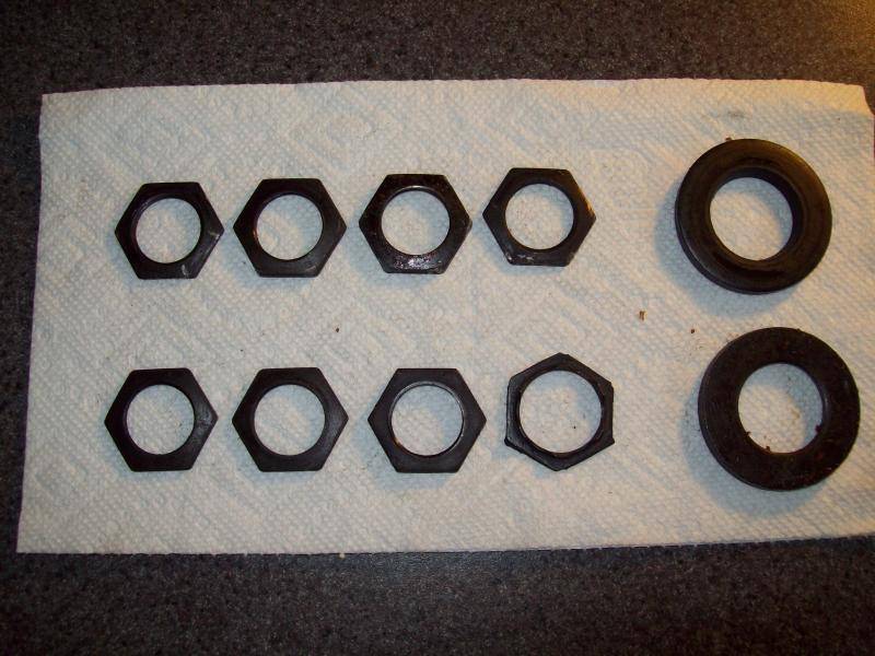

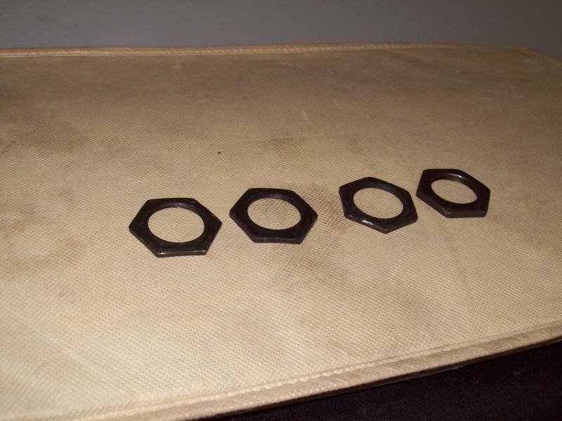

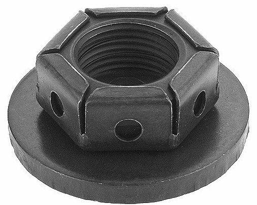

Finally got to it this morning and found the nut holding the hub assembly looked like it has an outer crush locking type collar on it. Can I remove this with a chisel or just prying or does it come off with the nut? The replacement doesn't come with this piece. I'm a little reluctant to muscle it off without hearing I won't need a new sub-assembly when I am finished.:)
Spindle nuts are one time use anyway. The cage is part of the nut. Just replace the nut with a new one.
They are not two nuts. The picture is misleading, the flat nuts are the pieces to the nut as a whole.
The new one will have a cage around the individual flat nuts you see in the picture.

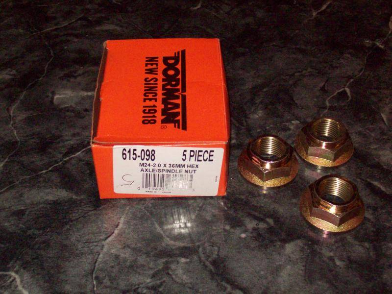

I'm wondering what's up, too? The replacements sold by AutoZone, Oreilly's, Baxters, and NAPA are all the brass-type OnlyTony has shown. But, my car has the type SlowMarkVIII has shown with his post. I'm a great believer in keeping a good thing, so switching in the middle of the gig seems foolish. Lincoln dealer? I try to stay away from them since on my previous car (a 95) their idea of fixed cruise was to disconnect. Huh? I fused it myself. I realize 240 foot-pounds should hold anything on, but why chance it if it is only a case of spending a little extra $$$. What say you out in LVC Country? I've got a week to figure it out while I wait for the $50 Timkens to come from back east. Locally they wanted $54 for Parts Master, who has a rep for less than long life - at least on the tie rod ends we put on a friends pickup. Timken has to be better, or am I fooling myself? ps- Thank you for the education, everybody. I've clicked all contributors.
PartsGeek $53.35 with free shipping. Plus, I found a step by step piece on Lincolns Online that shows the method with a chisel, bending the cage pieces back and then removing the two back to back nuts - complete with pictures. I may be wrong, but isn't one nut of larger surface area superior to two small ones? Maybe the replacements are superior to the factory?
PartsGeek $53.35 with free shipping. Plus, I found a step by step piece on Lincolns Online that shows the method with a chisel, bending the cage pieces back and then removing the two back to back nuts. I may be wrong, but isn't one nut of larger surface area superior to two small ones? Maybe the replacements are superior to the factory?
