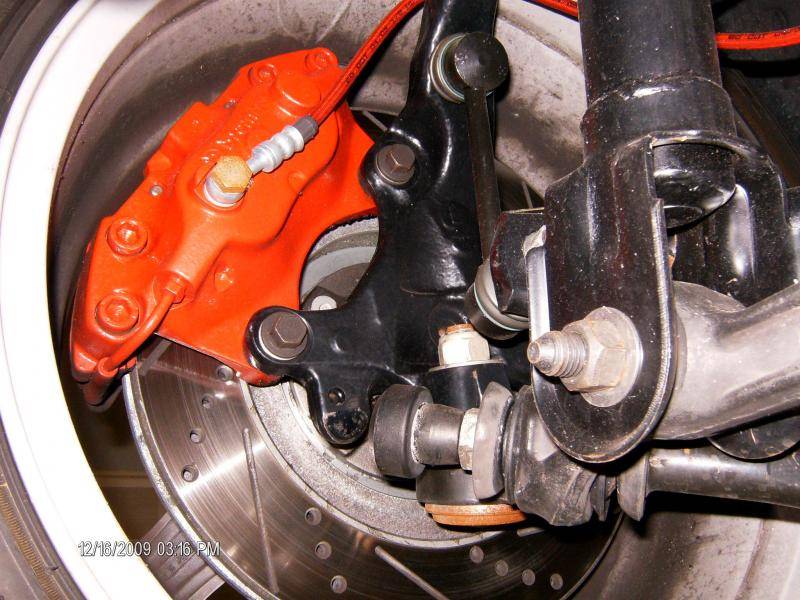

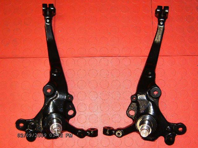

I had mine powdercoated.

Mine are satin black. I didn't bother replacing the splash shields on any of my cars. Probably wouldn't fit with the Brembo calipers, but I didn't even bother to check, just chucked them in the trash.
I did, however, use stainless steel washers under all of the nuts and bolts to protect the powdercoat.

use a smooth finish,not mini tex the texture holds dirt and is harder to keep clean. i know from experiance, a good friend owns a powder coating shop and ive helped him out over the years . texture is great in a cleaner area or where you have a badly pitted piece

mine are black as well, just use fiberglass tape when you blast them, don't really want to mess around getting the spindle all fed up
