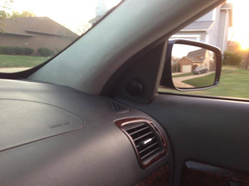

I have 4 OEM door speakers if you are interested in them. I'm running focal components now, but there aren't really any good places to mount tweeters in the doors, so I put the tweets in the front pillars, which sucked ass to run the wires thru the boots.
Most of the audio install is in this thread.
http://www.lincolnvscadillac.com/showthread.php?t=85604&page=2
I just went thru the whole ordeal, so if you have any questions, I bet I can help you out
probably a little late for this, but using an old car antenna fed through the boot makes pulling new wire super easy, the key is the right antenna, you want one of the newer thinner flexible ones, also you want it to have the ball at the end so it doesn't poke through, also makes it easier to move the end of the antenna around to help get it in to the boot in the first place.
or
if dealing with the boots is too much of a pain, there is plenty of room above the glove box for the crossovers to be mounted, then use the OEM wire to feed the woofers, then run new wire to each tweeter all while staying inside the car.
or
I did use wire :) The problem is that the computer is in the kickpanel and I didn't want to disturb it, so I drilled holes in the kickpanel metal and ran the speaker wires thru a grommet there. No matter how you do it, running the wires thru the door jams is a bitch and leads to sore, bloody hands lol

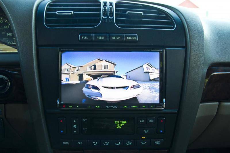

I looked through those pics and what did I see? You missing the chrome pc for your center vent.....haha
I like the install.....how's it sound?
Damnit!! I remember finding that little piece on the floor and having no idea what it went to :( That's going to drive me crazy
Strange, I was missing the same side chrome decorative piece for the center vent when I got my LS. The whole little slider that pops into place on the vent control was an $8 dollar stealer part and they had it in stock. They must pop out a lot on the passenger side.
Sweet. I figured i'd have to find an entire used vent assembly.. I'll drop by the dealer tomorrow
It was a little cussing getting it in. The back vent tube separate from the front panel.
While you have that vent assy out and on the bench, now would be a good time to re-enforce
the cheap mount for the screws that hold the Fuel and Reset buttons, which always seems
to break for everyone. Build up around it with epoxy, make it thicker and stronger.
Eventually the left side of those buttons will cave in because the screw mount in the back breaks.
Already took care of that with some fiberglass resin :facesjump
