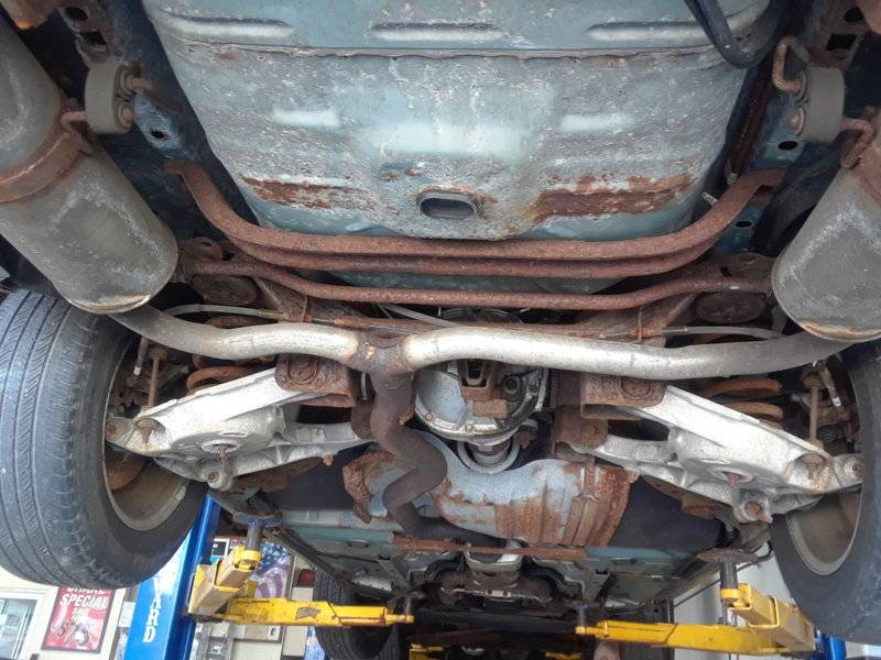

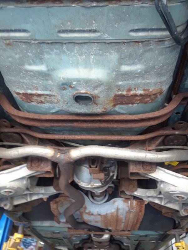

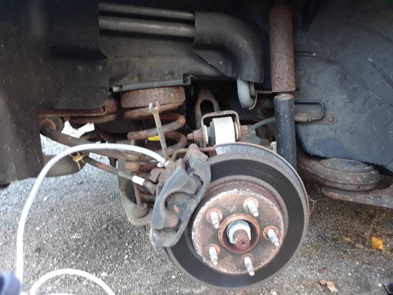

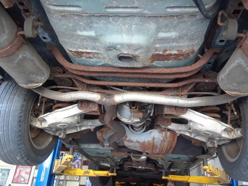

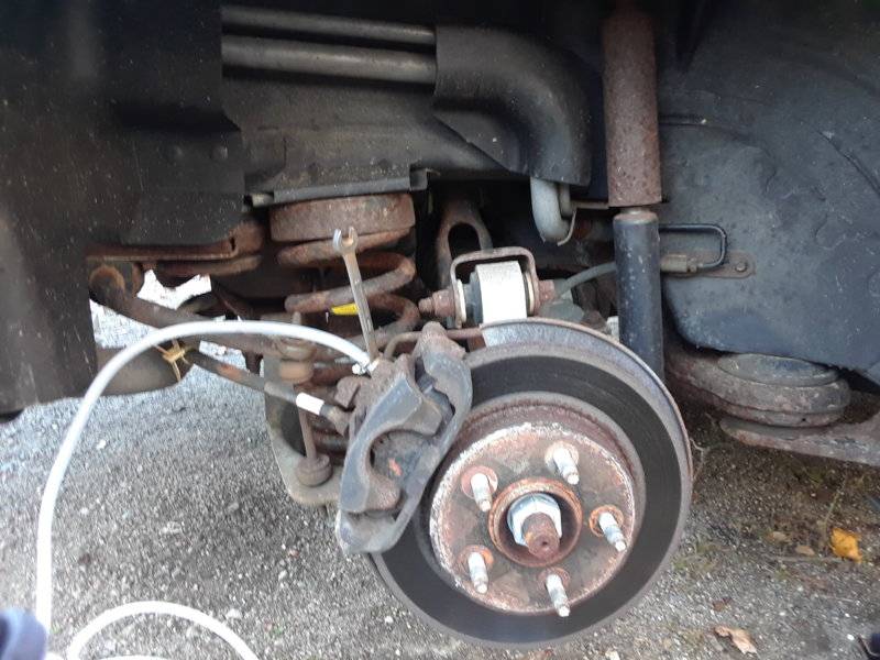

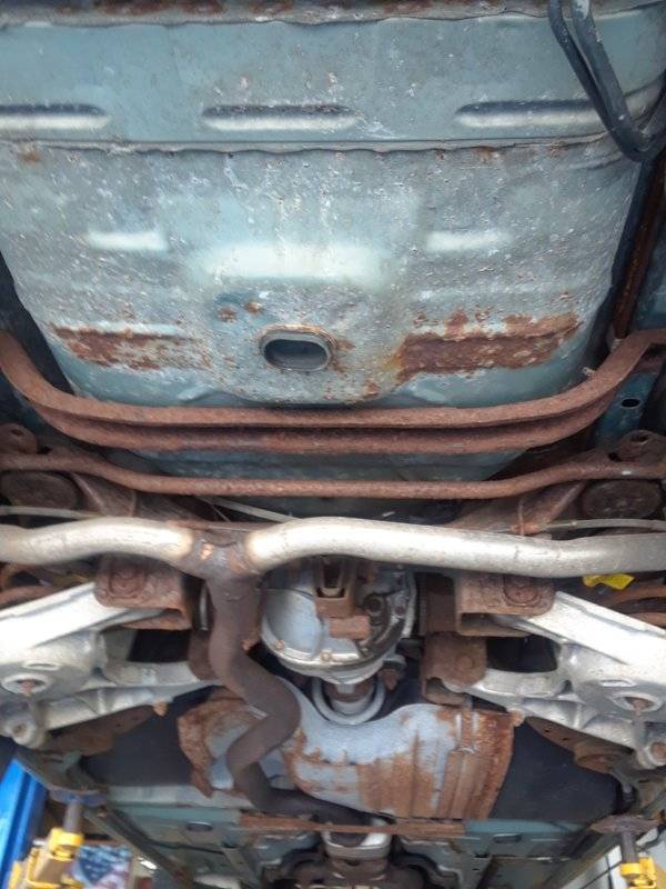

      Sounds like shes in a tuff spot. I'd get creative. If you had a cherry picker, you might be able to lift the front from the engine bay. Or Try slipping a bottle jack down in between the engine and rad and wedging it up into something strong to lift it. You could maybe pop the center caps off the wheels. If you could get a block of wood on the jack, and lift it from the lug nuts. Or slip a large pipe over the hub, and jack it that up at axle shaft. Lift it just enough and add some blocks here and there till you can get a regular jack under. Slip 4 dolly's underneath to roll it out. Either way be very careful please. I attached some pics of the underneath of my 1994 when it was on the lift. Hope that gives you a better look.
