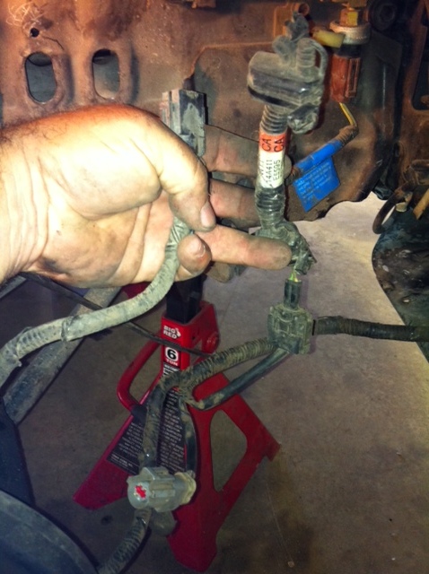

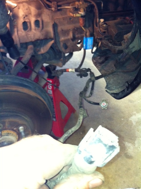

I pulled the pass side fender liner to see if my car has had the cruise recall, as soon as I dropped the liner a big long wire harness fell out. It has one newer looking plug, one really old corroded one. There is a blue tag on the speed control thingy but where the heck are the rest of these plugs suppose to connect to. There not any empty plug connectors in the area. The one that looks pretty clean is the one that has me a little baffled.
I figure with the blue tag it must have had the recall, I am not able to do the the self test from the steering wheel and my horn does not work so that must mean the clock spring is bad, bummer!!
Also did an oil change, that filter is just plain ridiculous. Thinking a filter relocate is in order this winter.

I like to see these things for myself, the link is handy to have. So it looks like the recall has been done.
The car is on springs since two weeks ago. All the air ride stuff is still there.
That may very well be the case boss, but before you do that, pull the fender liner on the driver's side and check to see that the same person who didn't tidy up that mess on the passenger side didn't for some reason unplug the connector that goes to your cruise control module. That module is mounted with two bolts up inside the fender. There is a ground wire for the horn in that connector. Just a thought... If your cruise control is currently working, disregard this post.
No cruise does not work, the one plug was for the air shock. I will check the for the ground wire. I have the fender liner out now so will look tomorrow. I also changed the fuel filter while I have it open.
Ok cool. If your cruise control is not working either that leads me to believe it is that connector for the module in the driver's side fender. Maybe they confused that box for an air ride control module and disconnected it. :p
