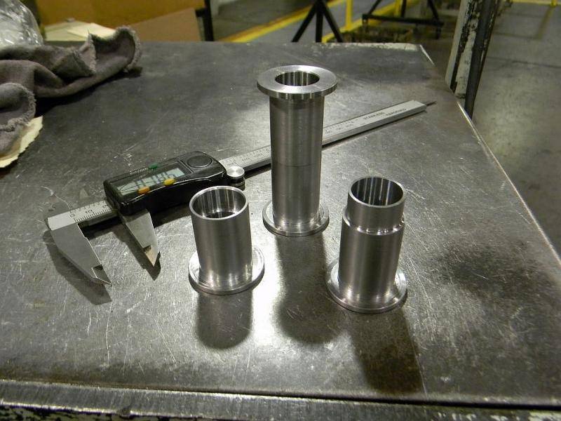

Only two sets left, don't know that I will be making any more...pm me an offer shipped! Or trade for gen1 interior parts in black.
One pc....made out of solid bar.
Pictured is what you will be getting....no paypal....cash or postal MO only.

im not trying to sound dumb but what are these? im guessing srb spacers is strut rod bushing spacers
They are the sleeves that go inside the SRB (forward part on the k-member) fords suck, and replacement sleeves don’t exist.

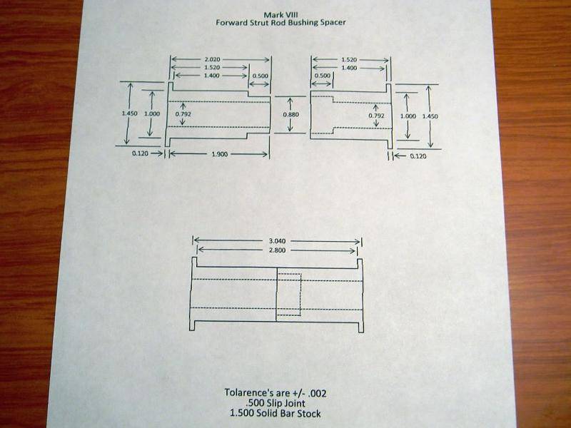

What size rod did you start out with Spree?
I used 1.5" solid bar, not stainless, then just painted them to keep them from rusting. If you or anyone else want to try making some. These were my dimensions.

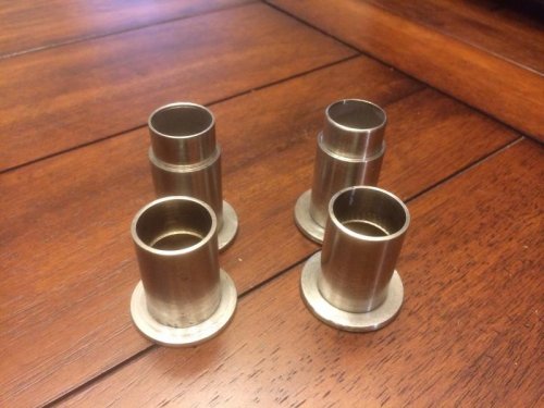

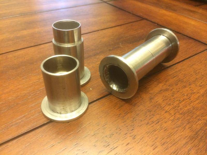

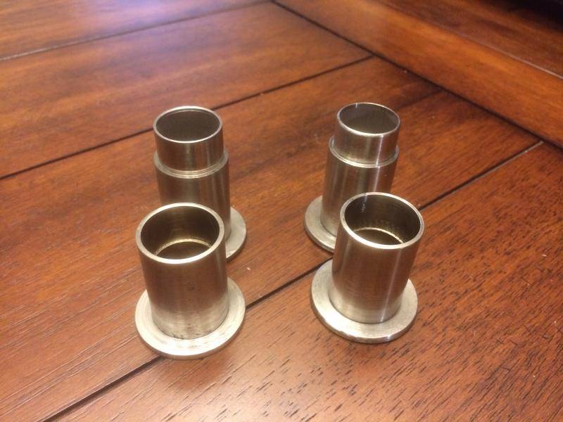

Well, I've finally got it all figured out.
I made a set of these recently from 304 stainless steel, and have enough stock on hand currently to make a couple more sets. Due to small size of my lathe, it was wiser for me to make them in the same way that DLF used to, by making the sleeve portion separate and then welding a washer to the ends. You can see from the pictures that the washers are fully TIG welded to the sleeves.

Nice Job!...look good...I'm glad you started making these!
They took me awhile out of solid bar and I haven't had the time to make any more.
