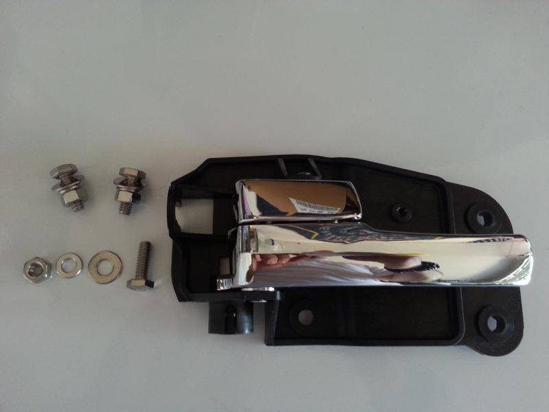

1/4-20 bolts 3/4" long with teflon lock nuts are needed to install the new handle. When you drill out the rivets, you will not go deep enuf to ruin the pannel behind the handle if you drill the rivet dead center

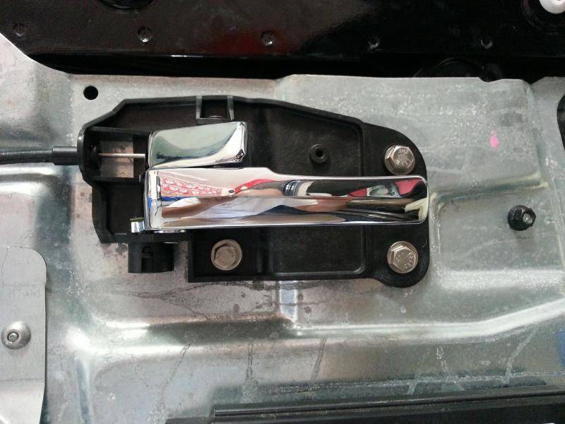

I drilled the old rivet out, bought and used the bolts from Lowes and I put lock washer in it. So far no problems, its tight. :headbang:
