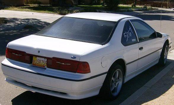

For all you "warmed over t-bird fans"-CL ad
Good luck. I would buy it, but i'm really trying my best not to buy any more cars before i deploy. lol. good luck with the purchase. :cool:
:D You owe me a set of cobrastars :D
That car has been for sale for a long time. Before I bought my mark viii I was looking for a supercoupe.
already got one lol:D
bad vibe from that sc...if it had wore a hole in the oil pan then he was probably drivin' it low on oil and possibly threw a rod bearing
and after it got too bad to where all the oil left the pan he decided not to drive it anymore and sell it...just a thought
Nice find, I've always liked the SC's. Hopefully its not like CobraStar said, would be a great deal otherwise.
just threw it out there. I'm always careful when checking out a car. Especially if i know of one thing wrong with it already.....
Not necessarily. The oil pan gets worn through very quickly once the motor mount breaks, and the only way to change it is to either drop the K-member or pull the motor, and then you have to source an oil pan too. I could easily see someone parking a car because of it. The simple solution to that though is just pour some oil in the thing and start it up, and see how it runs.
