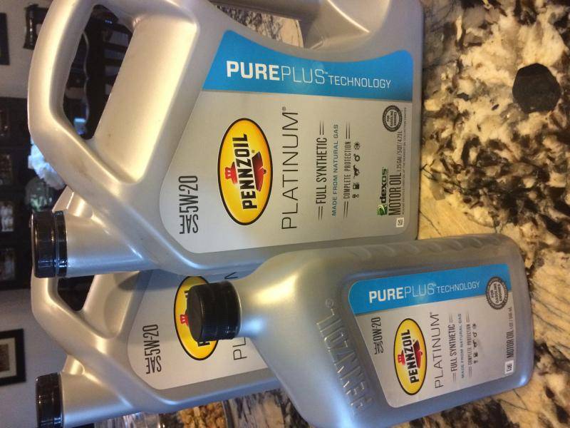

I am running the exact same oil but 5-20 like you supposed too. IMG_0776.jpg
(the 0 was for another vehicle)
Good luck with using 0W20 in a ford that was design for 5. GM put out a bulletin that said it was OK in select vehicles, 0w20... 2015 and up GM use 0w20 in all models including light trucks. Dexos licensed of course...
When we run oil analysis in ford modular motors running 5w20 most oils are about wore out by 5k miles. Full synthetic we get more. Lots of variables go along with that though.
0W20 vs 5W20 is not going to matter that much. In fact, many folks run 5W in the summer and 0W in the winter because the 0W will flow a bit better at low temps. Slapping straight 40W into a car that needs 5W20 would be a problem, because the bearings are specced for a thinner oil and the thicker oil simply won't get in between the bearings properly until the bearings wear down enough that the oil molecules can slide in. Sure, some will get in there but not enough will make it in. On top of this, the thicker oil being pumped by an oil pump through an engine designed for lighter oil will build too much pressure. In fact, this is a used car dealer trick to increase oil pressure on a car with a worn engine. They put really thick oil in, and the oil pressure comes up. Lasts until the owner changes the oil.
