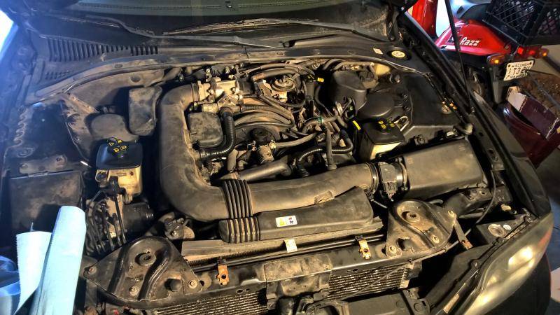

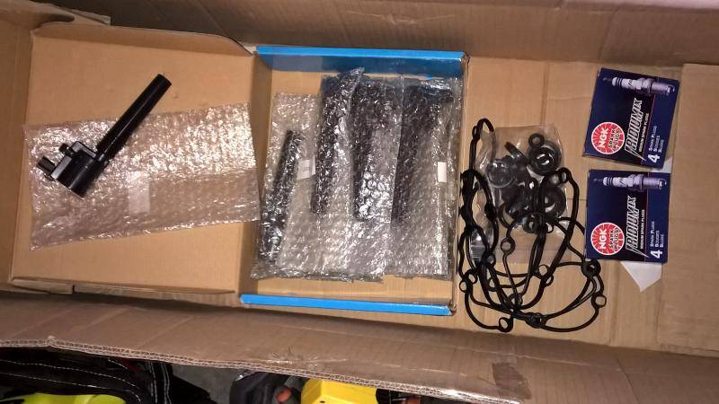

I got started on my repairs tonight but unfortunately I only got a few minutes of work done since I had to head into work. Here are the parts I am replacing.

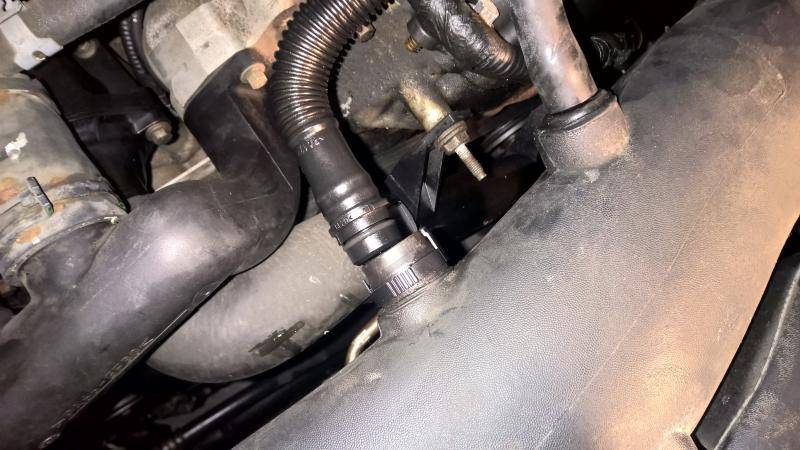

As I started taking the intake tube off I realized that one of the connectors was broken so I'll have to get that new plastic tube that connects to the intake.
On a very good note it looks like all of the plastic cooling pieces have fairly recently been replaced! YAY!!! :wrench

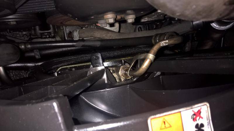

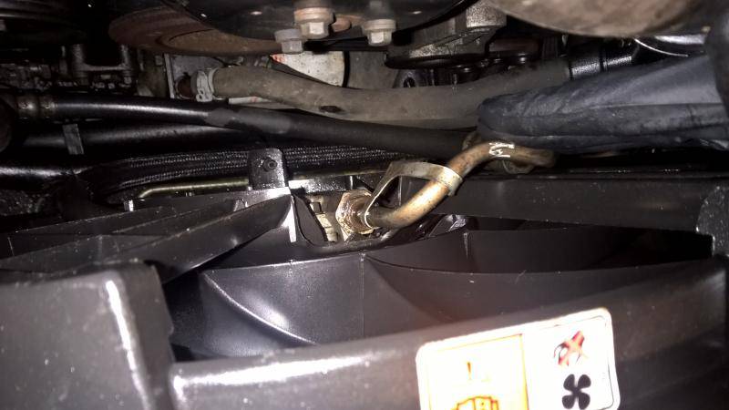

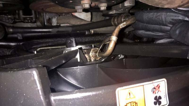

I also got a closer look at the connector at the cooling fan. If it is leaking at that hose or fitting only it should be a pretty straight forward fix, yes? Do I have to worry that the pump has been running dry for who knows how long with the previous owner? Here are a few pis of how much I could move the hose with my finger and you can also see fluid around the connector and where it ran down.

I got the plugs and coils installed today. Luckily the gaskets were still good so I will save the ones I bought for when they are needed. Since I did not have to remove the valve covers I also did not get a chance to take a look at the timing gear but I will probably take a look at that this summer. Last thing I wanted was to have to put more time than I needed to in when the weather is still in the 30's.
Get everything back together and I'm happy to have a smooth running LS! Brakes are next on the checklist and I still need to figure out where the leak is on this cooling fan or decide if I just want to go electric.
I have that tube if you want it. I grabbed it from a junkyard for someone else back in June but they're obviously not buying it now. I pulled it off a '00 V8. I could get a shipping quote if you Pm your zip code
