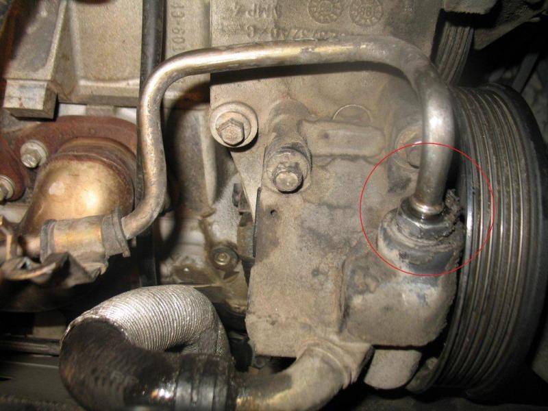

Right there behind ya Rugger. I was replacing my A/C compressor sunday and my P/S hard line at the fitting at the P/S pump I think either got tweaked and is now leaking or was leaking. Looks like i'll be replacing the P/S Pressure line now as well.
See my picture and post here: http://www.lincolnvscadillac.com/showthread.php?t=64662

As far as the 18mm flare wrench goes, i will get one and try it but i think it might be almost impossible to use it due to the Pully location. Even with it exposed.
I'm more worried about tweaking this line again when i go to reinstall the A/C compressor. Maybe i'll have to install the compressor 1st and then install the PS line. What a pain!

It's close. You may have to do what I did and just get a small pair of good vise grips on it. You don't reuse any of it so you don't have to worry about tearing it up. I laid there looking up for about 3 hours before I said "f it, going with the vise grips". It's so tight you almost can't get any leverage. I thought of just taking the PS pump off but the bolt blocks access to the retaining bolt so you just have to do it the hard way...

I was able to get the old fitting off at the ps pump end with a 18mm flare wrench. It was accessible since I already have taken the A/C Compressor out of the way. Now I'm going to replace the PS Pressure line since it was leaking between the tubing and the fitting and i understand that rubber seal is not servicable per this info i found.
"If a leak occurs between the tubing and tube nut, replace power steering pressure hose / power steering return hose assembly.
If a leak occurs between the power steering pressure hose nut and the aluminum steering gear housing or power steering pump outlet, replace the Teflon® seal only. "

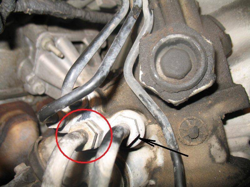

Ok now I'm stuck again. On the power rack end. I can't figure out a way to get two wrenches on both the fittings. The lower fitted that goes into the rack itself needs to be held in place (it's a 19mm sized fitting). Other hard line fitting for the PS Pressure hose is a 17mm sized fitting which a flare wrench can access.
The only line i'm trying to remove is the one circled in Red. I'm thinking the only way to get this line circled in red off properly without mucking it up is to remove the other line (with the Black Arrow) that seems to be hindering access to it first. That way i can get another wrench in there to hold the lower fitting in red so it doesn't twist off.
Then, hope i can find appropriate washers for it at the Auto Parts store.
Let the good times roll!

Or do what our friend right on the mark says and cut the bad line and get it out of the way, then maybe you'll have the clearance to slide a wrench on the back nut from the bottom left area and a socket on the top one?

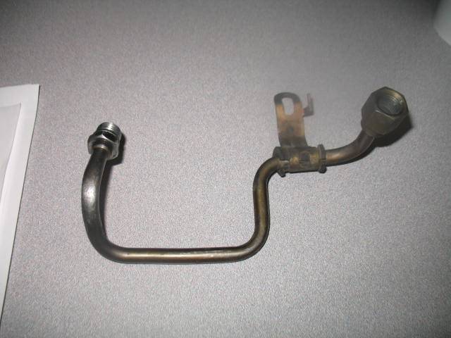

Well as it turns out. I only needed this part below, not the Power steering pressure line which doesn't include this part. Had to order it through Max and got it today.
Will install it hopefully tonight or tomorrow.
Mine was definitely leaking from that point, not just turning. There is a small rubber washer in between the nut and tubing that must have got messed up/dried out.
