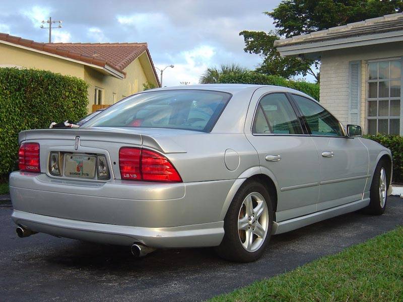

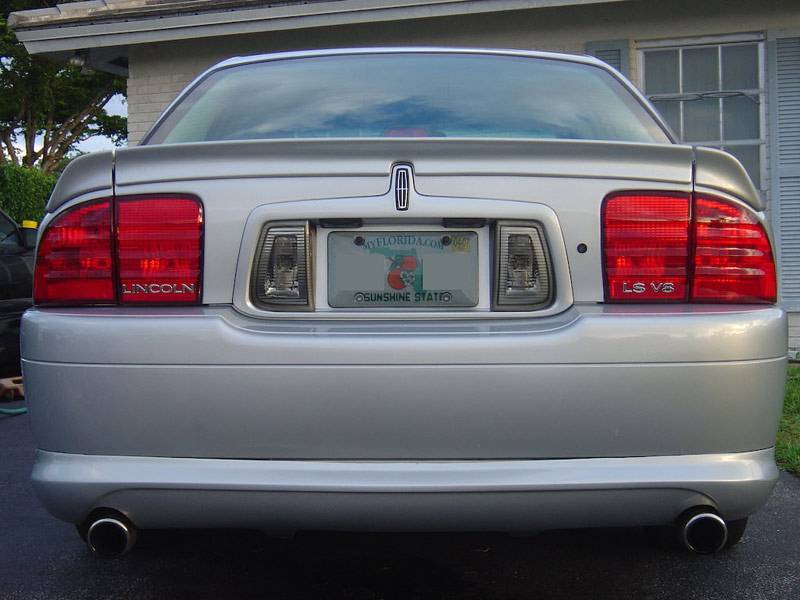

Borla tips
Borla tips- see my gallery
cut plastic valence with a dremmel, cut the stock tip's bend off so it was straight, and clamped the new tips right on

nice work,, ur tips are clamp ons?

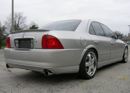

These are 4" Magnaflow stainless tips. If you us 3" tips they won't angle downward once you cut the rear valence.
This system is no longer on the car... she's back to stock while she sits in storage.

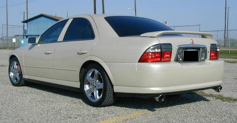

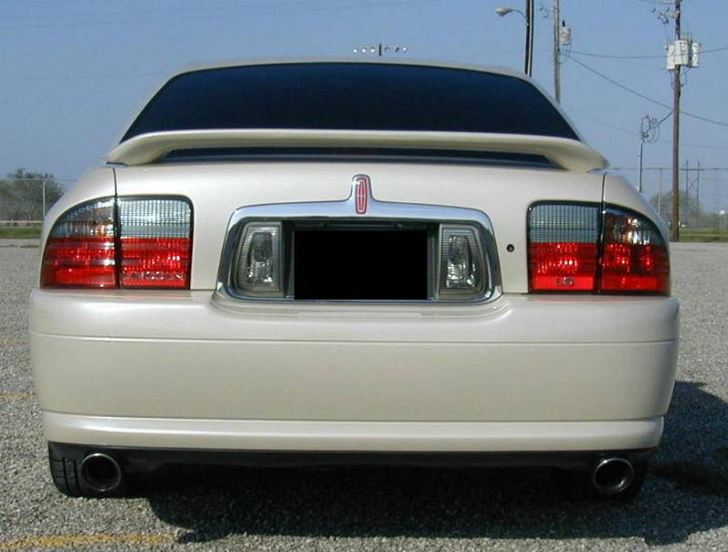

Put my exhaust on this past weekend, I will post some pics tomorrow. I feel that maybe the tips are a little too big, I would like some opinions when I post the pics.

Im thinking if I bring them up a bit, If you look at the picture that looks down at the tip, they barely come out past the bumper, but when you look at them from a distance or the side, they appear to be farther and lower than they actually are. they are right below the black trim, when I go higher, Im going to have to cut it.
