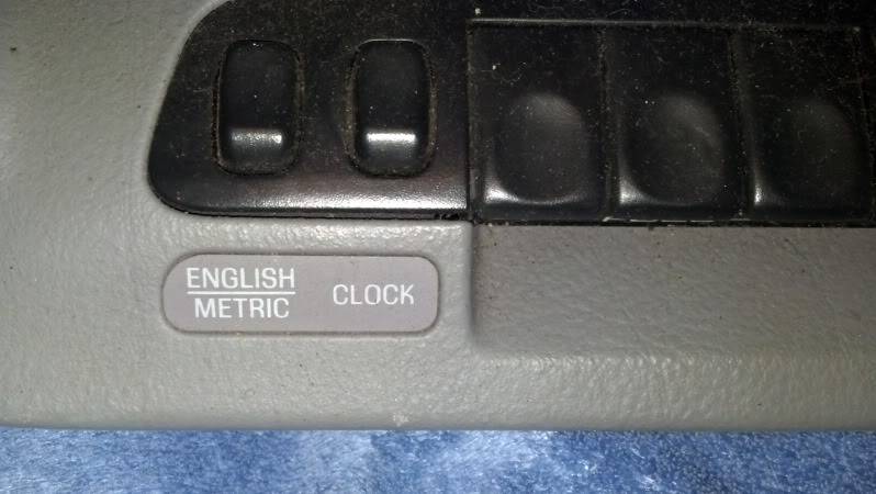

ETAC displaying C* not F*
How do I set my ETAC to display Degrees F?!
It's displaying C*
It's displaying C*
Mine only does Fahrenheit and I'm in Canada, bought it on LOD I think. The message center button does not set the ETAC. I don't know if it can be set any other way.
I LIED YOU ARE CORRECT THAT BOTTON OPPERATES BOTH!
Now will a 96 EATC work in a 95?
I put a 95 one, I believe, in my 93 and it only does Fahrenheit no matter where the rest of the displays are, they all do metric just fine.
Found out the problem, one of the connectors on the back of the EATC is messed up
