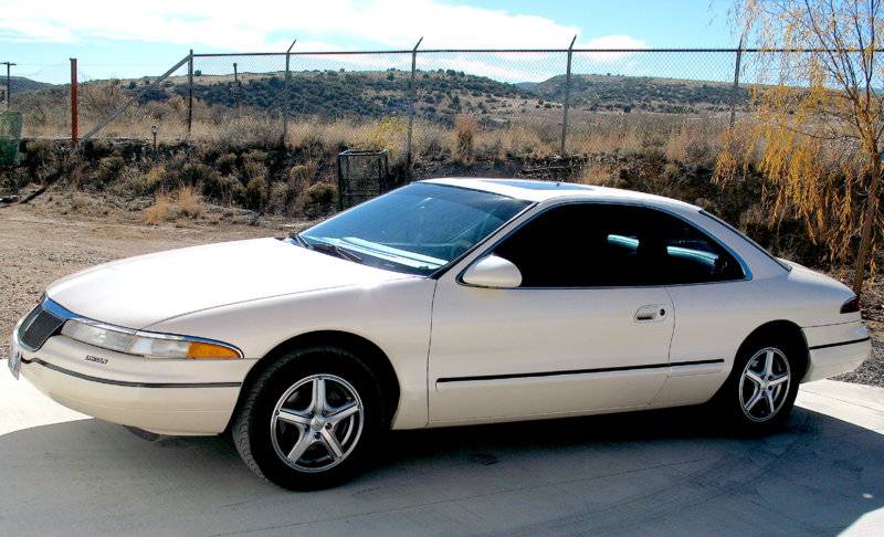

          Here is how it looks with the wheels washed and waxed, and the 1/2" black stripe applied.

            Very nice ivory Mark you have there.
