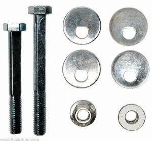

They say some cars have the adjustment some dont. guess what i dont and its $44 per wheel plus labor and new alignment.. Its visably off so i have to have it but i just dont get where this bolt is supposed to go and why it costs so much. My question is has anyone else had to get this for thier ls??

Once again good point. Just wish i would have known this before hand to take into account as far as price... I really dont want to chew up my tires so i will get it done. Found the part at rock auto for $27 but not sure of quality of parts from there so ill prob just pay the $44. Will post pics tomorrow

Those are what I posted about through RockAuto. They go through the lower control arms.
