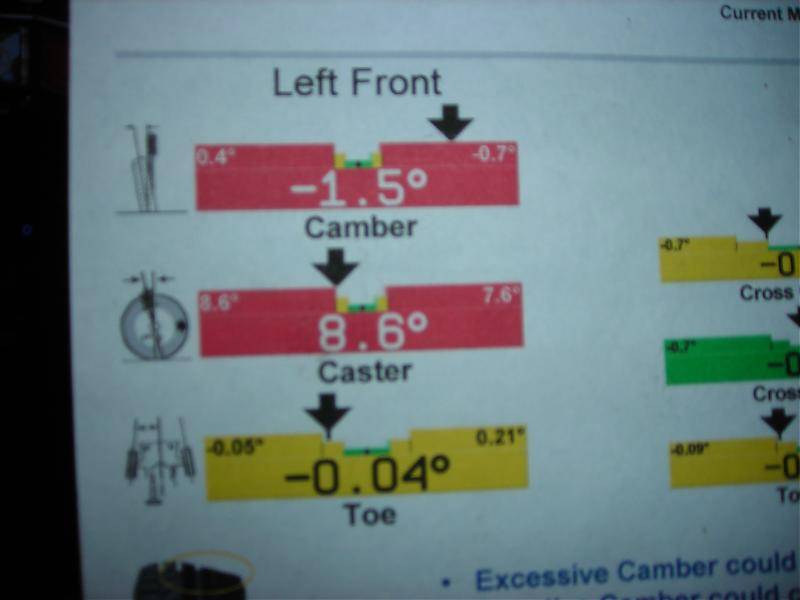

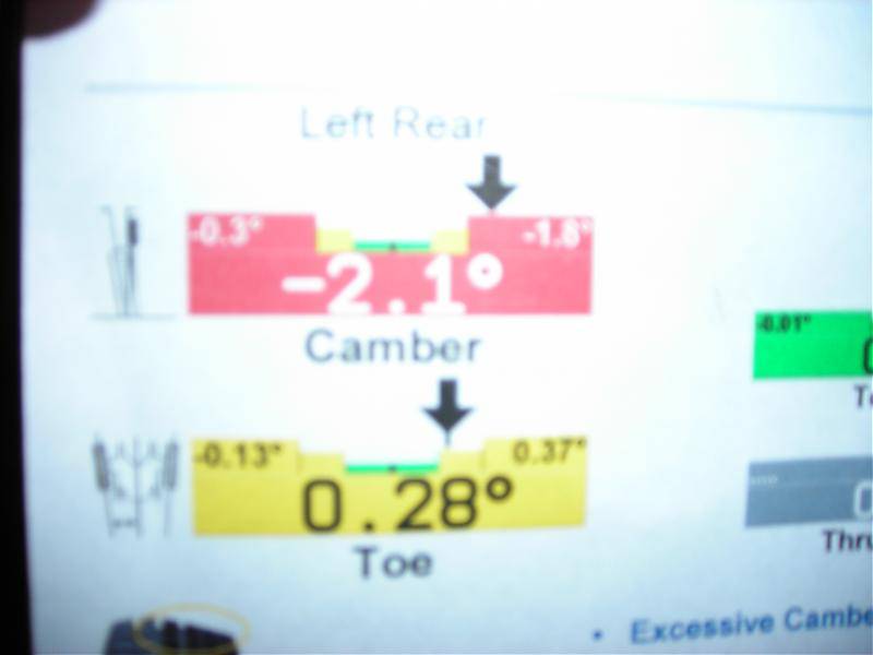

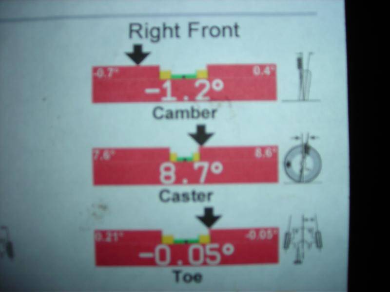

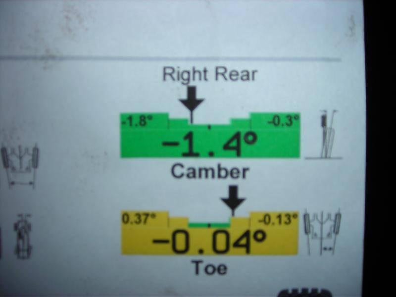

Ford is telling me there is no camber adjustment on my car and wants to charge me 426 to install them .. they say they wheels are off 1.5 degrees and 1.2 degrees on the other side on the fronts .??? whats the deal with that ??? havent heard nothing on threads about that
Ask for the print out if you have doubts. The machine does not have a program called lies but for some reason these techs do.
Not that I think they are BSing. It is common. Unfortunately it is also common for them to scam you but if you ever think it should have the alignment done just do it.
have the print out in front of me. but what im saying is why does my car not already have the cam adjustment?? they are 60 a piece
here i print out

Yes. From the print out they need it.
Some say you shouldn't need a kit to do the alignment but they also suggest taking it to a very good tech for that.
Do you know for sure how much they cost???...
Both sides are visually off so i guess i gotta do it but they want 229.00 for labor... they didnt tell me over the phone that they were replacing the left rear control arm.. they told me this once i got there whch made me wonder if the cam deal is to offset their loss. So total is around 400 with new alignment... so i guess i must pay to play as one said before.
