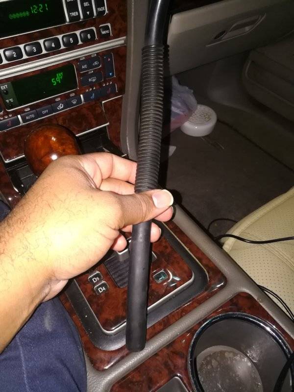

The couplers leave much to be desired, but I'm use to 3 ply and better. These are 0 ply??? Shouldn't matter since they'll see a whole 0 psi.
The crank case breather barb is a 1" diameter fitting. I would post pictures but the intake has already been removed from the car. That 1" fitting isn't a quick disconnect either.

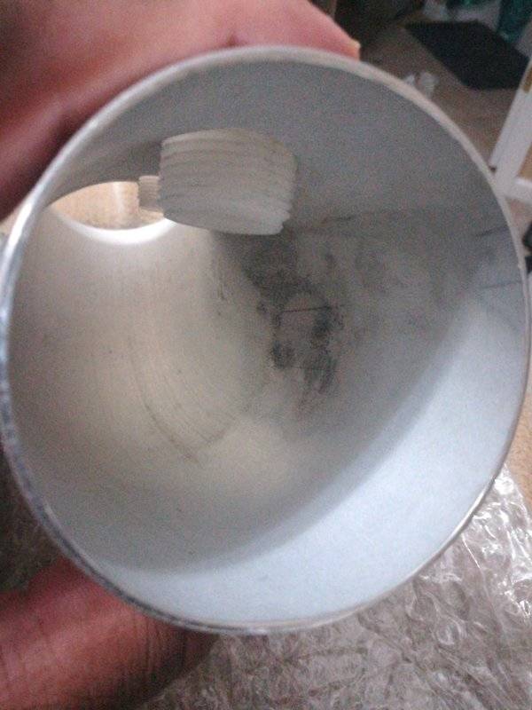

1. Check for metal shavings still attached to where the pipe was drilled.
2. Wipe the pipes down internally.
3. Consider sealing where the the nylon fittings meet the pipe, since it could potentially let in unmetered air.

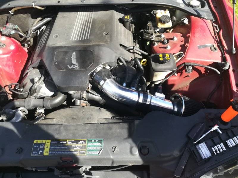

The 1st Gen cold air I bought looks like better quality than this 2nd Gen ...looks like the same metal tubing though ...you could always place some gasket maker around the threaded plastic fittings to be assured they are a nice tight seal...I could really have fun modifying this ...now I’m thinking about buying this for my 2006 ...but from what I see the factory cold air intake that came with the car is one of the most solid air intake system I've seen

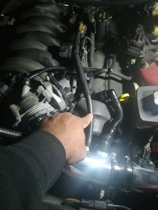

I had to trim some of the rubber hose with a utility knife. I trimmed enough off the sides to slide it in to the quick connect for the 1" breather Barb. The other issue is the 2nd smaller hose isn't long enough so you'll need to replace it . I wish that I would have installed it before I installed the exhaust. It comes with a bracket that you have to bend and secure the intake with. I didn't bother. Maybe I'll try to weld it one day. Maybe I'll trash it and get a K&N one day.

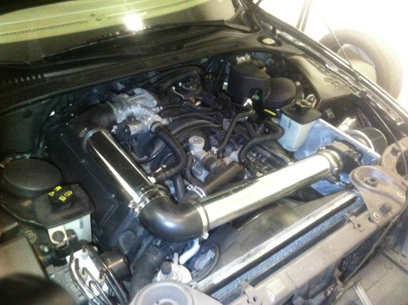

Looks like the same filter as the Gen 1 Ebay Cold Air Intake System ...This system gave a bit more beef to the sound ...but not to much which was a relief because personally one of the things I like most about the Lincoln LS is that it's a quiet yet powerful snappy V8 ....I don't like loud cars never have never will..you can actually hear the filter suck in air while the car is idling...It was like the thing was alive and breathing lol
