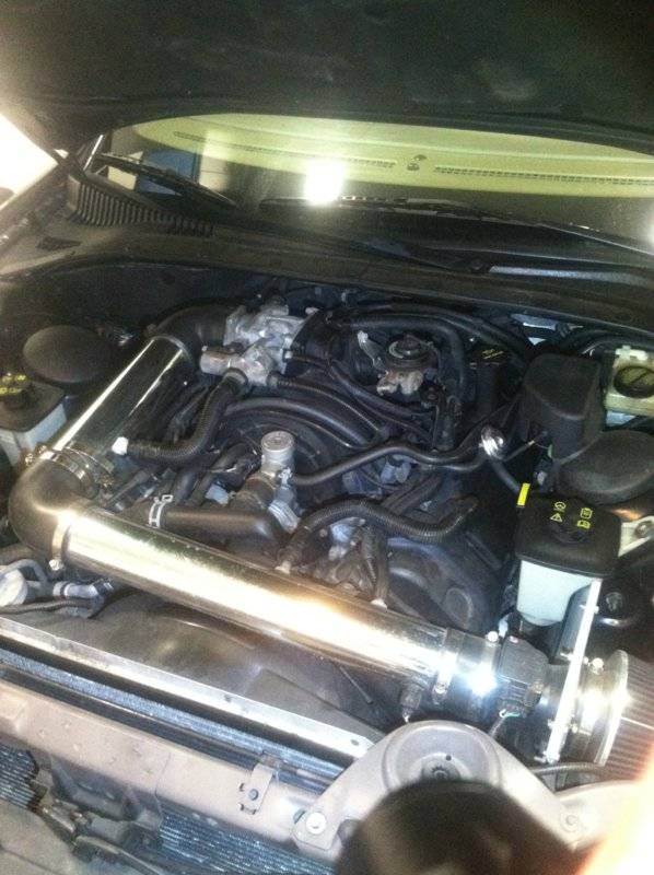

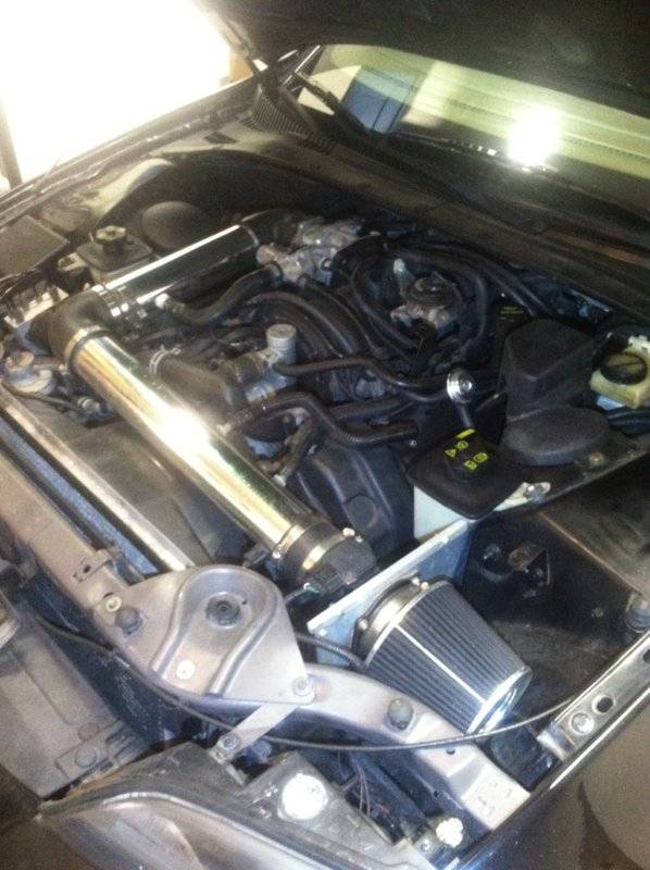

Yes I bought this cold air intake system for my 1st 2001 LS 3.9 it made the car breath way better than the factory ... The factory is still good ... Just wanted to experiment and I'm glad I did...I built my own heat shield also which turned out better than expected ...I was going to run a air inlet tube from the front bottom of the car into existing air hole also but never got around to it

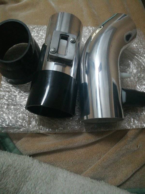

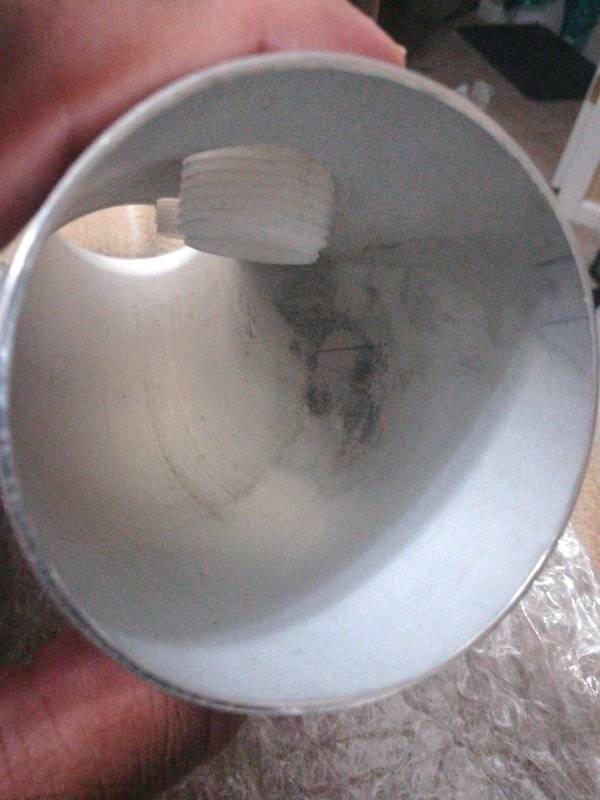

Come on guy don't skimp on the info. I guess I'll find out in a second.
OK here's the kit minus the filter.

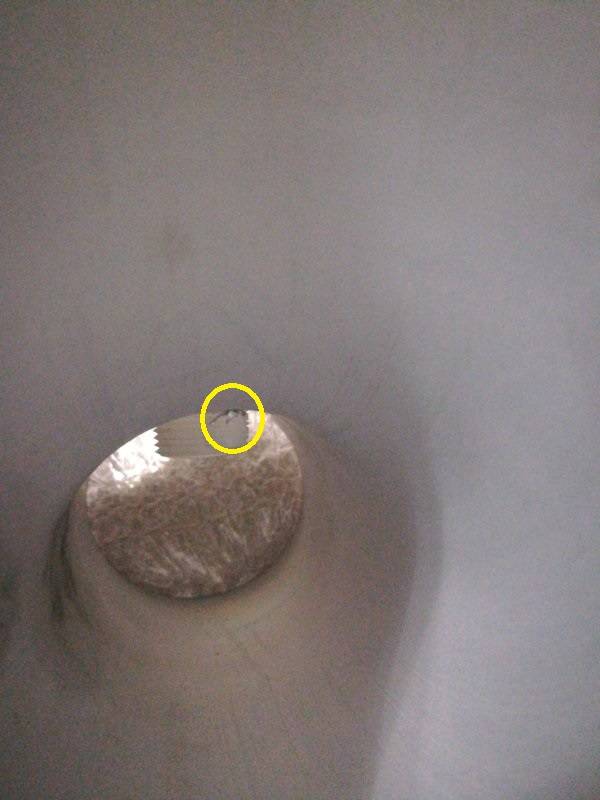

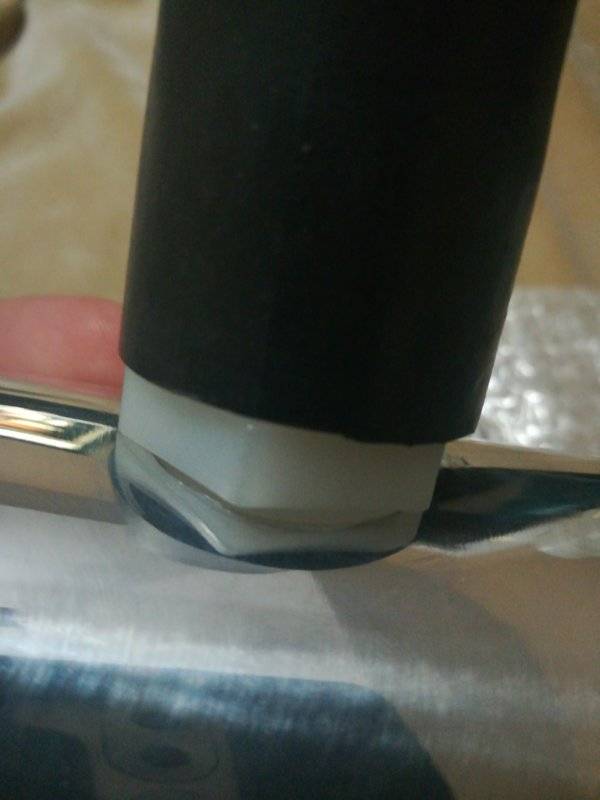

I would:
1. Check for metal shavings still attached to where the pipe was drilled.
2. Wipe the pipes down internally.
3. Consider sealing where the the nylon fittings meet the pipe, since it could potentially let in unmetered air.
