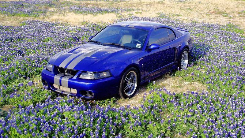

Well he is running 24lbs of boost now, 80lb injectors, tripple Ford GT supercar pumps and dual drivers. :lol:
Yeah I have seen that car in a few threads. Makes getting a Cobra more tempting than before. Course as of late I have started getting the F-body itch... for the thousandth time. :lol:
