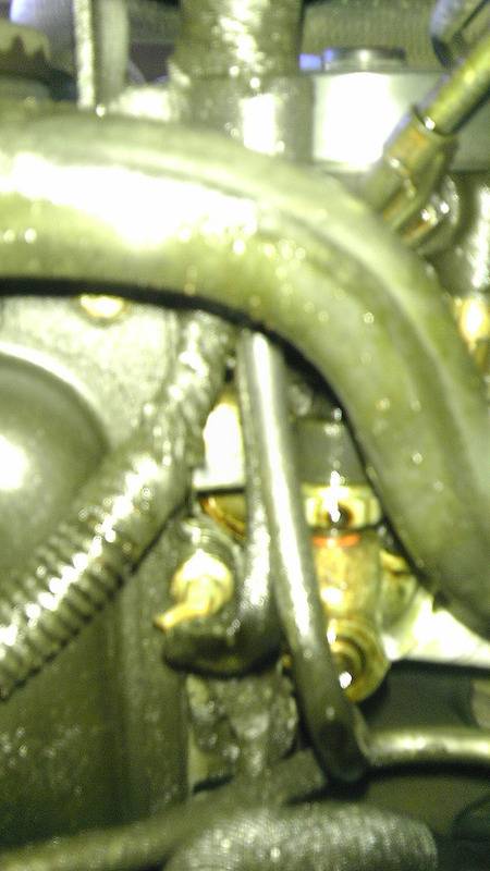

I had to pressure wash the underside of the car, the drivers side block, and really watch it to determine the oil filter gasket was leaking. I thought at first it was the oil pressure sender but there was oil coating places it couldn't be from the sender alone. I had quite a bit of oil on the ground before replacing the gasket, then with the sender leaking only it was less but still obvious.
It coated my engine, transmission, exhaust, everything with oil. Now that is all clean, no more oil coating the driveway.

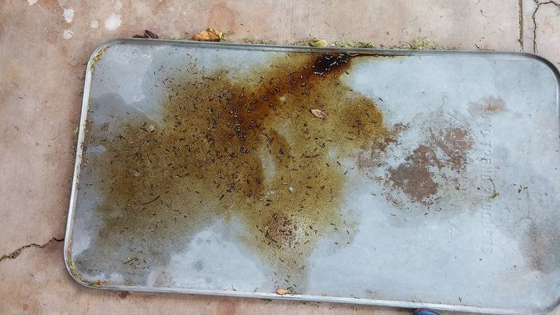

This is what I would get dripping off everything when parked (this is probably parking the car over the tray 3 times:

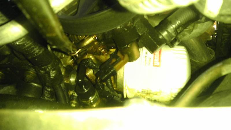

The oil filter gasket wasn't the funnest thing I have ever done, and I struggled with it, but obviously it much easier to do than an oil pan gasket. I am sure I could do it much faster this time, removing the drivers wheel to and going through their makes a couple bolts easier than trying from underneath.
