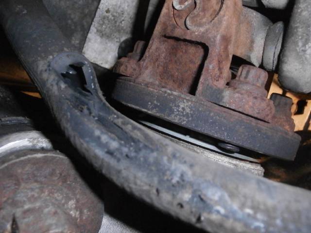

filled up with 93 today after work...about 1/2 gallon gas poured onto the concrete upon fill up...leaking from above the drive shaft tail; there's a cross-over, loop hose connecting the pass and drivers sides of the tank....when I put everything back together I left that hose hanging down upon the drive shaft (theres a place to snap it into to prevent this from happening)- the hose has a big ass hole burned into it, hence the leak and smell...when I first started driving after fp replacement, I heard it happening but did not know what it was at the time...damn
---the hose looks like 7/8'' o.d....5/8'' i.d?no place to get that hose tonight...gonna try to repair with the plastic spout from a gas can and two more clamps
repair was pretty easy...
after I disconnected the hose from the drv side I pulled it down and found the damage

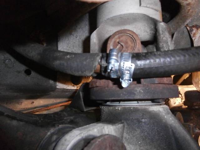

I went to the local parts store but didn't find 5/8'' i.d. fuel hose; so I cut out the damaged fuel hose segment then cut a 2'' length of 1/2'' copper plumbing pipe to make a splice inside the hose
snugged up the clamps, pulled it back into place, but AWAY fron the drive shaft, and it looks like this now:

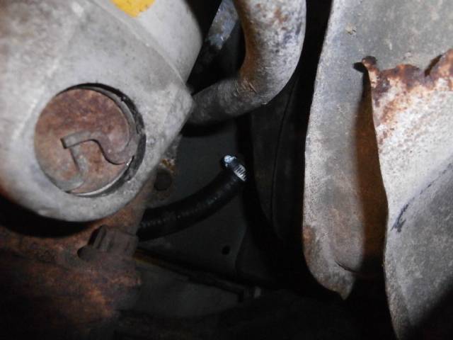

pass side

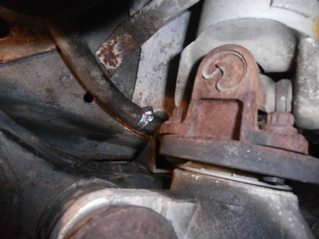

drv side
no more fuel leak! hopefully the copper tubing is a safe/effective long term solution
