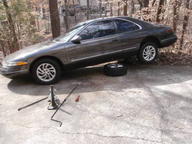

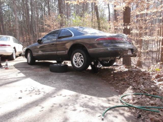

this morning, my car was on the driveway.....I lifted the front LH too much and the jack at the rear RH took off!!!
yes, that's my 3 ton jack by the rear RH wheel..turned up, wedged, repairable
that 17'' tire was under the passenger door for safety; the car was lifted about 12'' when it shifted off the driveway
Dang it!

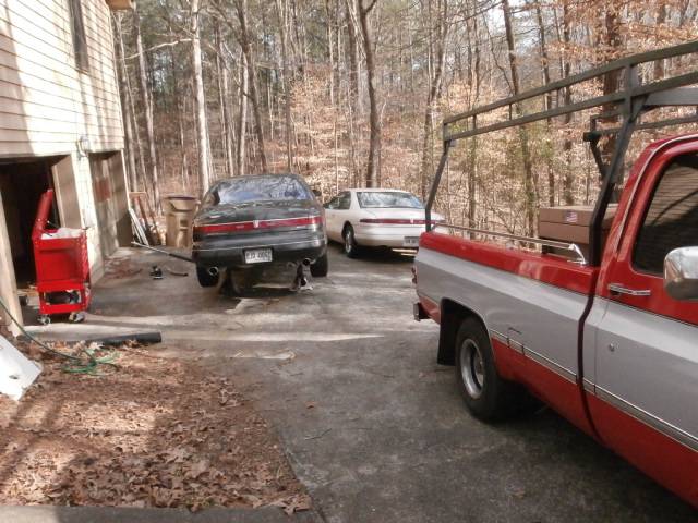

tow truck on the way, try again on the flat spot
Tow truck? You can't just move the white one out of the way and push the brown one? Don't you have 1 friend to help give a shove?
And go buy at least 2 jack STANDS..don't EVER trust a jack to hold the weight with you under the car
towing is free with insurance, probably couldn't push it forward b/c the jack was holding it up...but then it would just be further down the hill/slope, now it's moved and onto the flattest spot I have...new cotter to repair jack, try again...drill pump siphon

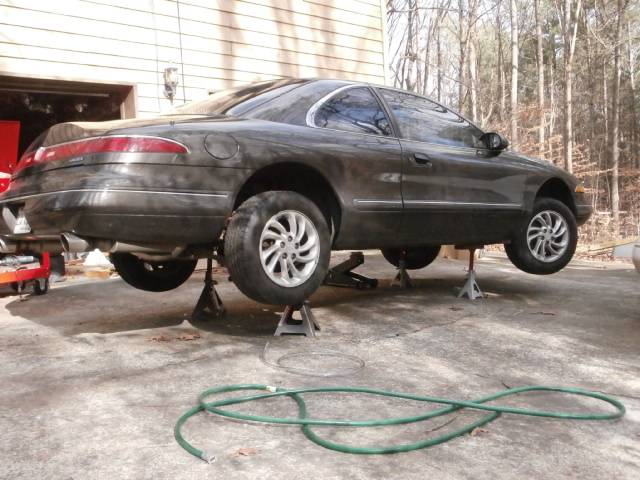

back in action (thanks for the tip on max lift 1sik)
high...but high enough? rear stands are 6 ton 24''..not maxed out yet, maybe get more with a 8x8 block?
the front stands are 2 ton and they are maxed out
That might just be enough that seems adaquate to pul tank down and slide out with a jack, my only concern is that lean I would but the jack on that driver side in the middle on the pinch weld.

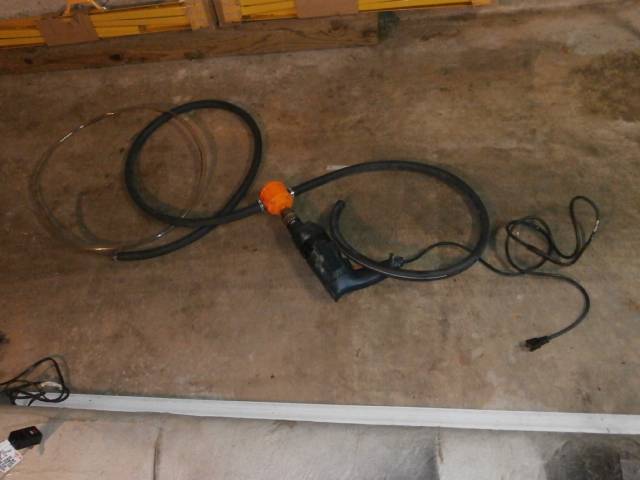

it took awhile but I got the tank (mostly) drained; that cheap plastic Drill Pump failed after draining about 7-8 gallons-inside fins broke down/deformed from the gas; I found a HD one that doesn't deform with exposure to gasoline; used a clear 1/2'' tube to go in the tank, and (2) 7/8'' hoses that mated up to the larger drill pump
That's a very not good idea using a drill for that.. you ever look inside the cooling vents as one is spinning? LoL
yea, it was arkin/sparking up a storm....oh well, tools are meant to be used...it's what I had at the time...I pulled that short rubber hose between the gas tank and the filler neck; if I wanna replace that hose, what should I use? will std coolant hose work ok?
