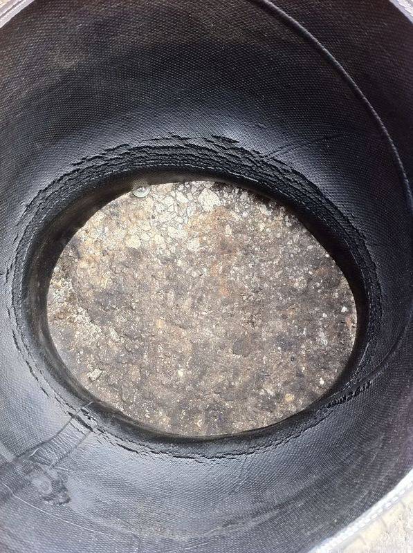

Just put 12v to the solenoid to open it. I wouldn't put anything in the bag that hardens... The bag will no longer be able to flex. The only thing that I think would work would be an inner tube patch from inside, but even then, the flex of the bottom roll of the bag will pretty quickly make it fall off. If you were to turn an old bag inside out, you would see a LOT of cracks in the rubber. You don't see them from the outside, but that is why the slime works, it fills all those holes while allowing the bag to flex freely.

Just FYI, this is what the inside of an old bag looks like.
