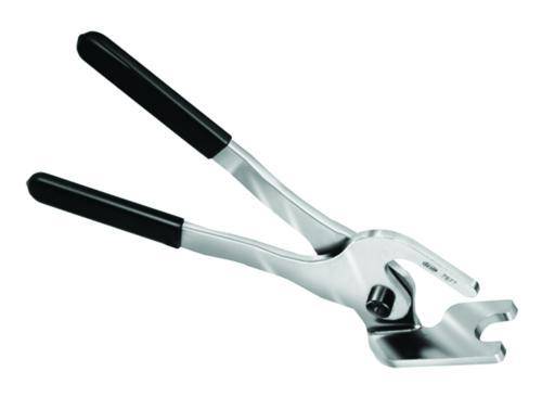

Whats the easiest way to unhook the rubber piece in the rear that holds the exhuast up.

The correct tool. M-5230-T7677

On the other hand I like a good carnage thread so just spray PB blaster in the rubber hanger then slide it off.
Those things rock! I bought a cheap one though from Autozone once but it broke after the third one. :( As much as I have to drop these damn things I should buy another one though..... a good one like you posted though.
Meh, PB Blast and a good yank works well though.
