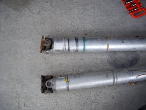

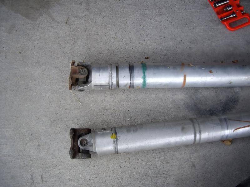

If its not posted by the time I get home tonight I'll take a pic of a 2 piece in my garage and post it.

A 93 DS is like it says is one tube that has ends welded to tube on both ends. The 2 piece DS has trans end welded just like 1 piece but the rear end side is the tube in a tube end. If you look at that end of DS you will see a 1/8 GAP where the weld should be.
^This. There is a distinguishable difference that is plain as day. The problem with these parts places is they tend to label shafts as a "93-98" Mark8 driveshaft. While that is partly true that they fit all year Mark8s, a true one piece was only found on the 93s and have that 1/8" gap. Make sure you know exactly what you are getting. To be honest man, I don't know how on god's green earth you twisted that shaft unless something maybe bound up in your differential. Either way, it happened. Get a 93 shaft and call it a day. If I was to go back, I would have not spent the money on the 4" unit that I have. The factory 93 shaft will handle all the power that you could put to it with a good high-speed balance. Don Pfau is running a supercharged 93 Mark8 with the stock shaft and 500+ rwhp. Unless you are cracking the nose in the air when you launch, you'll be fine and in order to do that you'll need 9s and 750rwhp.
The one on the bottom is a 93 and the one on top was installed on 94-98 IMGP0014.jpg
