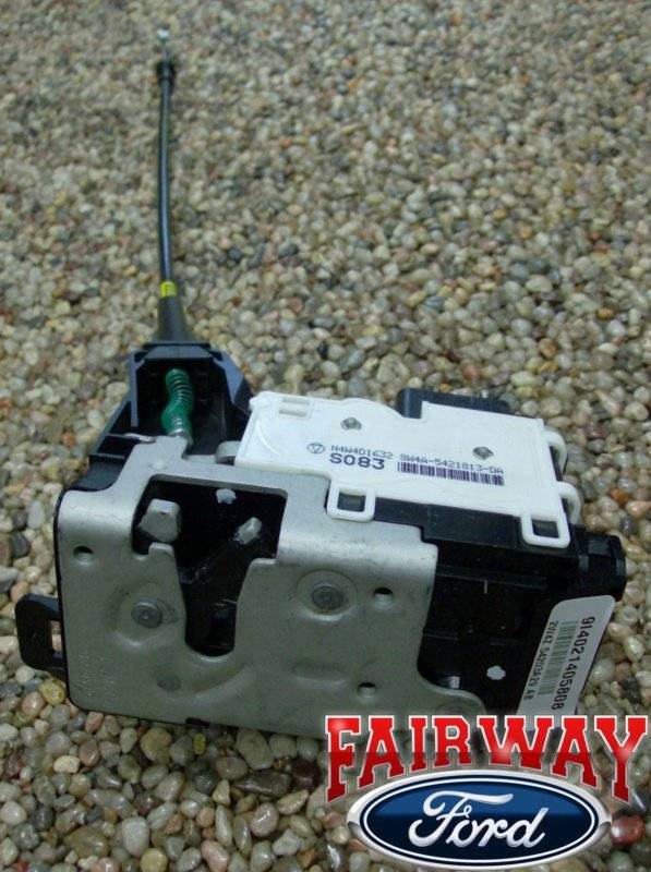

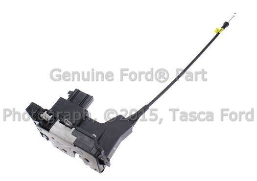

Is the latch this part# 2W4Z-54203A29-AB and that part includes the latch/latch assembly/actuator all in one part?

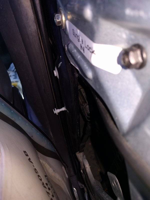

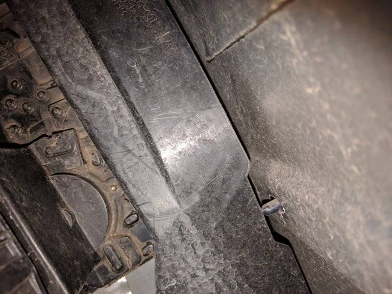

I pulled out part of the inner panel/trim. I don't see or feel anything to move. I assume the latch/assembly is behind the area that I put a red rectangle on, where the plug is.
This is the highest resolution image I could find of the correct part:

I don't see how I can move anything, nor how to get a chisel or anything in there to tear it apart.

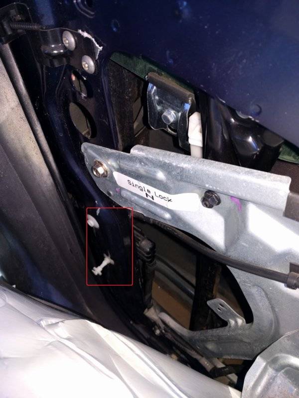

If you remove the window regulator, including the bracket it is on, you will have much greater access. You can see the electrical connector to the latch in the pictures. The interior door handle cable runs to the top of the latch. On the right hand side (your right, as you are trying to get to it) of the latch are the levers for the exterior key lock and the exterior handle. A plastic clip holds a metal rod from the door handle, and the metal rod from the key lock goes into a hole on the other lever from the latch.
It's not super easy, but you can get to those levers even without removing the window regulator.

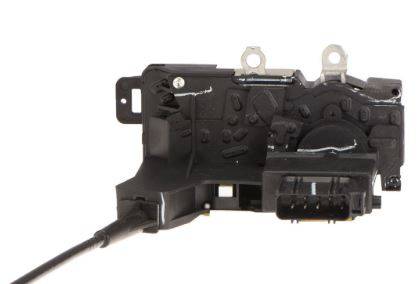

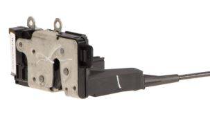

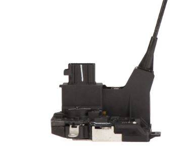

https://imageshack.com/a/img921/8126/HXyN2W.jpg
https://imageshack.com/a/img924/5537/7Xwbf4.jpg
https://imageshack.com/a/img921/1769/FsKx8X.jpg
https://imageshack.com/a/img923/297/DkHNea.jpg

You can see the levers I'm talking about in the pictures above. They are most clear in the last picture, the latch is on its side in the picture, so the two levers are sticking straight up. With the latch mounted, they are towards the outside of the door.

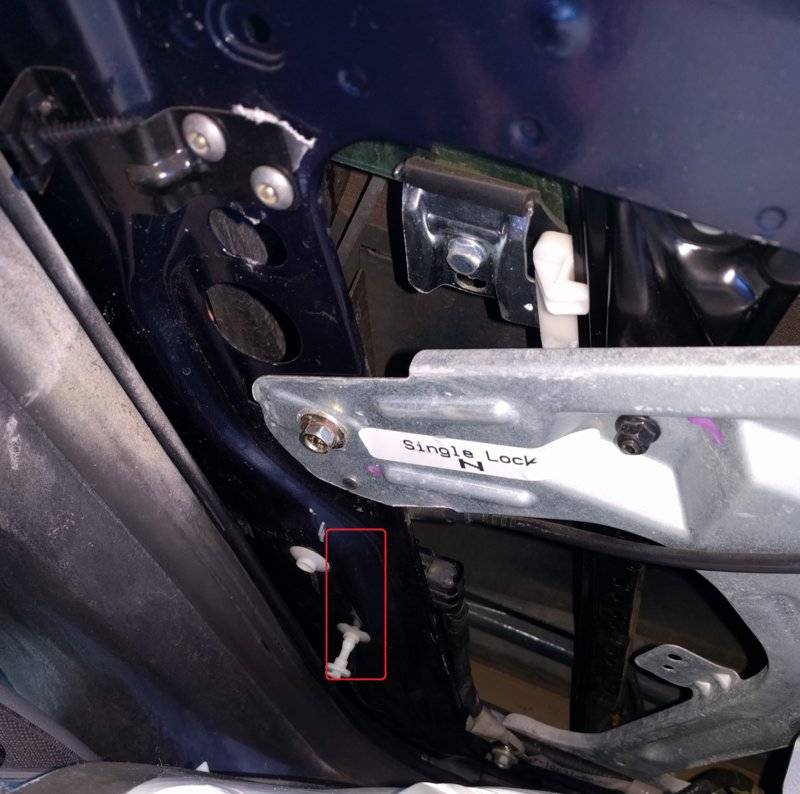

I am able to move the latch assembly levers by hand but the latch did not release. The door won't open. There is a plastic or rubber guard covering the levers, it has to be folded back to expose the linkage/levers from the latch assembly to the exterior door handle/lock.

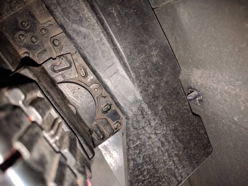

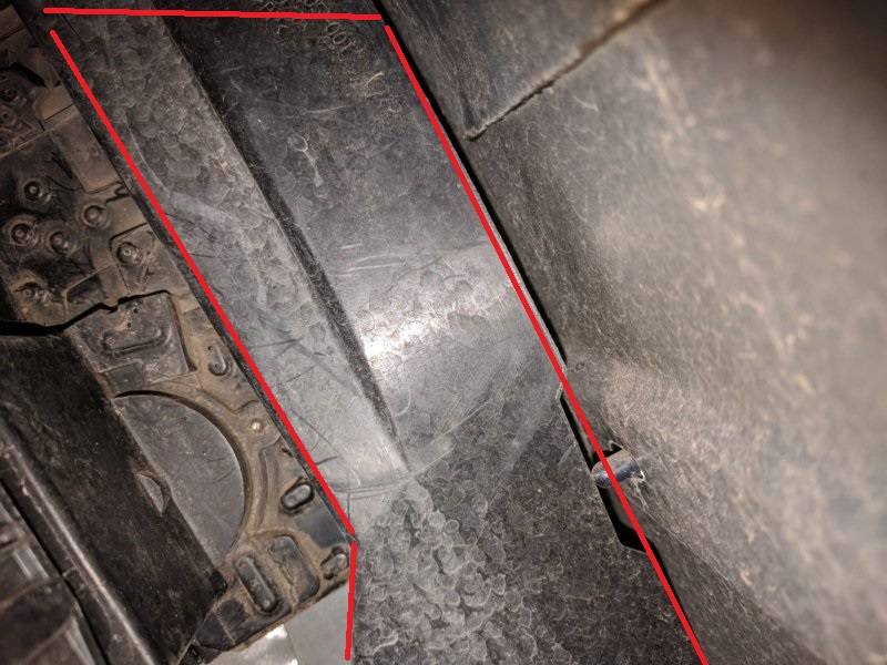

Just curious, as I can't get in there to see where this is connected, how do you remove the black rubber guard, see image that I outlined in red? I'd like to remove that, so I can see the linkages/levers on the latch assembly. I want to remove the lock lever and throw the lock/unlock lever by hand to ensure the door is actually unlocked. Plus it would be easier to see what I am dealing with if that rubber was removed, if I proceed to chisel the part out...
