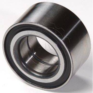

yeah. looks like this.

Is this pic of the rear or frt. Bearing?
