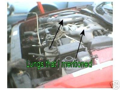

I just realized you have the gen 1 tube and I have the gen 2. But I'm not familiar with the "lung" term. What's that? Thanks for splanin.
Yeah....being you have a Gen 2 you do not have the dumb a$$ed lungs I am referring to.
The pic below is what I am referring to.
:Beer

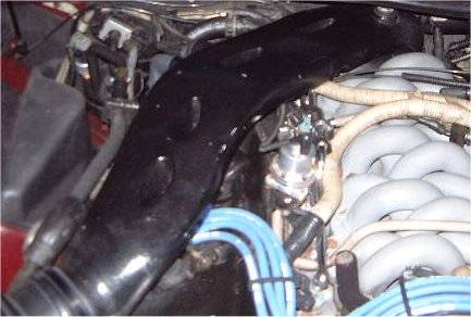

Markviiiedrea said:
saws all, fiber glass, and krylon!looks great!
SAWS ALL???? Holy sh!t batman......talk about the wrong tool for the job......why didn't you use a sledgehammer instead..... :Bang :Beer

Markviiiedrea said:
saws all, fiber glass, and krylon! looks great!dint feel like cuttung my air box up
