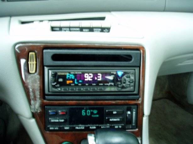

Can ANYBODY tell me were to get this kit from? I don't wanna pay $100+ juss to have my Flip-out screen & My Panasonic CD Player nearby.
(DVD Player is going in the Glove Compartment)
By The Way, I got the pics off Ebay & the kit caught my eye. :feed
its actually not a "kit". that piece was made out of a sheet of ABS plastic cut to shape, bent horizontally convex, and glued to the inside of the stock bezel. the abs was then cut out to hold two individual single din radios. i have to make them all the time for those f-ing caddy's where i work, no one makes a pre-fab unfortunately. (double DIN by the way means one single opening the size of two DIN hieghts, not two seperate DIN openings)
ps, if you dont believe that that kit is a DIY, check out the choppy jagged cut on the black abs plastic above the top deck. or the gap between the two decks together. looks like $h!t when you actually notice that, now doesnt it?
