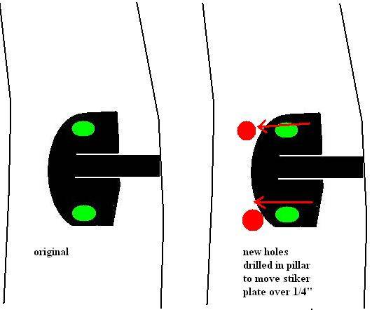

im just wondering if i should drill 2 new holes?

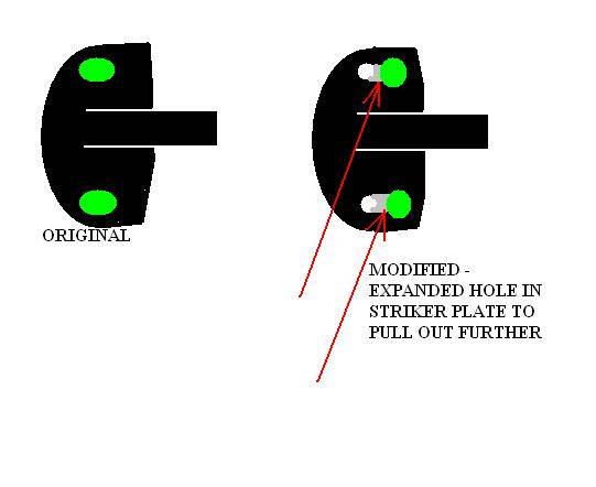

i have like only a inch of space between the original holes and the end of the metal frame, if i moved the plate out a 1/4 inch should i drill new holes for the striker plate, or can i modify the striker plate where i could slide the plate further out, and bolt it back tight like that?
or should i do this the other way and make new holes on the frame

I would try modifying the stricker plate first. You could probably elongate (sp) the wholes on the plate to give you some wiggle room.

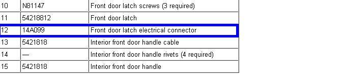

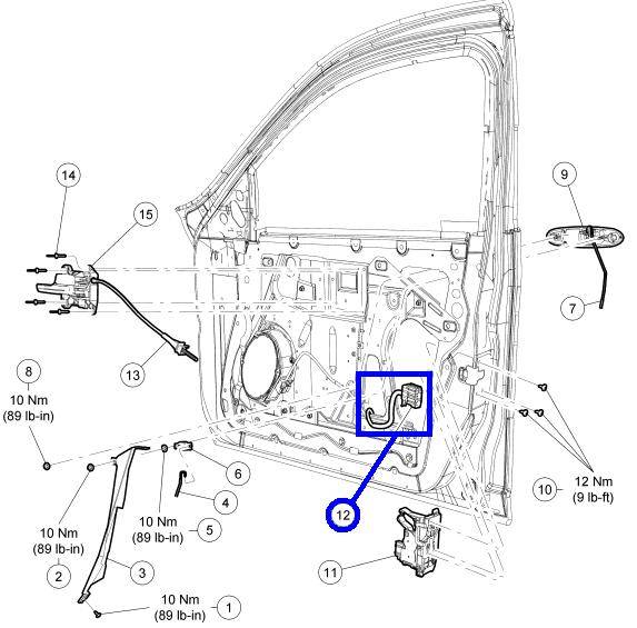

my question is now, does anyone know the electrical wires on the door latch connector? these is 4 wires, 3 on the bottom and 1 about 3 pins over at the top. it plugs directly into the door latch.

Just disconnect them one by one until the door ajar message goes out. Reconnect the ones that aren't related. (They're for the electric lock/unlock.)
I don't know the gen I wire colors.

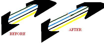

well before cutting any wires, i had the car on, and just unplugged the whole connector, and it said the door was still open, so im figuring when the door is shut is connects 2 wires to each other to message the computer the door is closed, if they arent connected for any reason the door is open to the computer, so does anyone think im right about this and that i need to find the 2 wires to connect?
or could it still be just one wire?
Okay, I got the polarity of the signal wrong, so disconnect = door open. If gen I is like gen II, then you need to connect the black wire to the black/yellow wire.
I GOT IT, thanks everyone, i had to cut 3 of the 4 wires before i found it out. i didnt cut the black one because i assumed its the negative for all 3 wires, and i had cut the thicker yellow one, but nothing happened, it was the 2 other wires, they were the "2colored ones", i just ended up crossing those 2 wires, i just kept playing around with it until i finnally heard the dash keep beeping every time i cross the right wires, so i taped it all up and its all good now!
