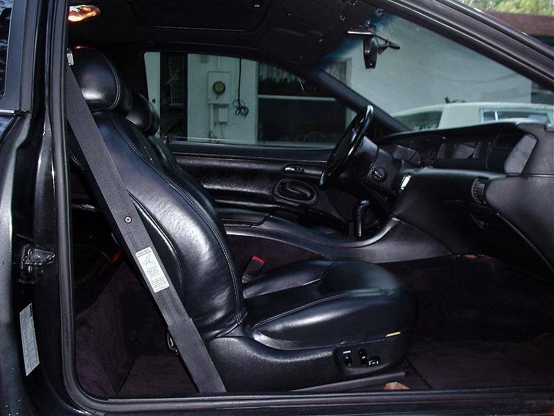

yes it can, it will bolt right on just like the gen 1 panel, the hard part will be cutting all the switch plugs out of the gen 2 and figuring out how to wire them to your gen 1 to make all the door switches work. i have black interior in my 93, and a pair of gorgeous black 97 panels, next time i get a 2nd gen in, im cutting all the plugs i need to do the swap. so i'll find out how bad its gonna suck!!!

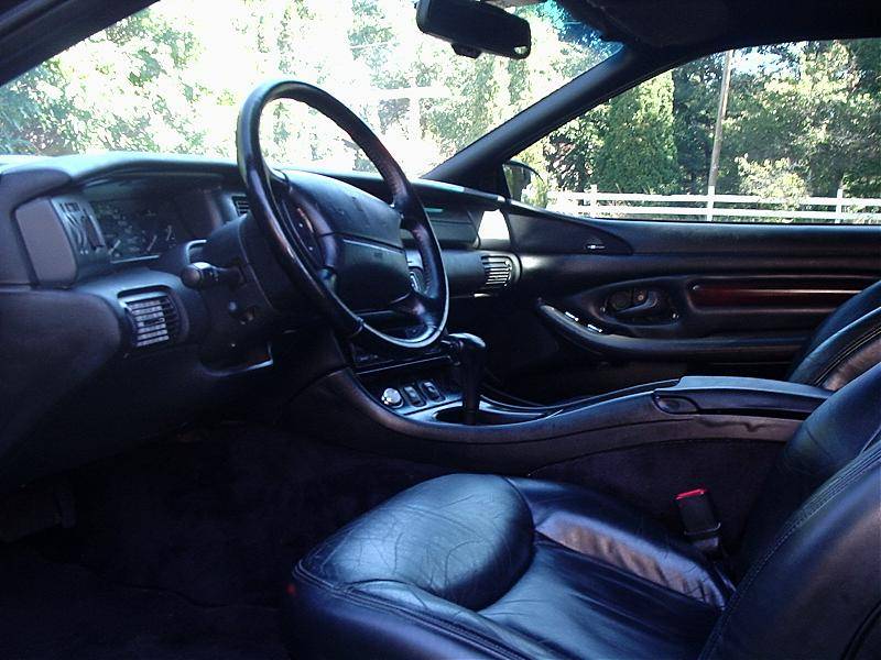

this guy did..... its a 96 lsc

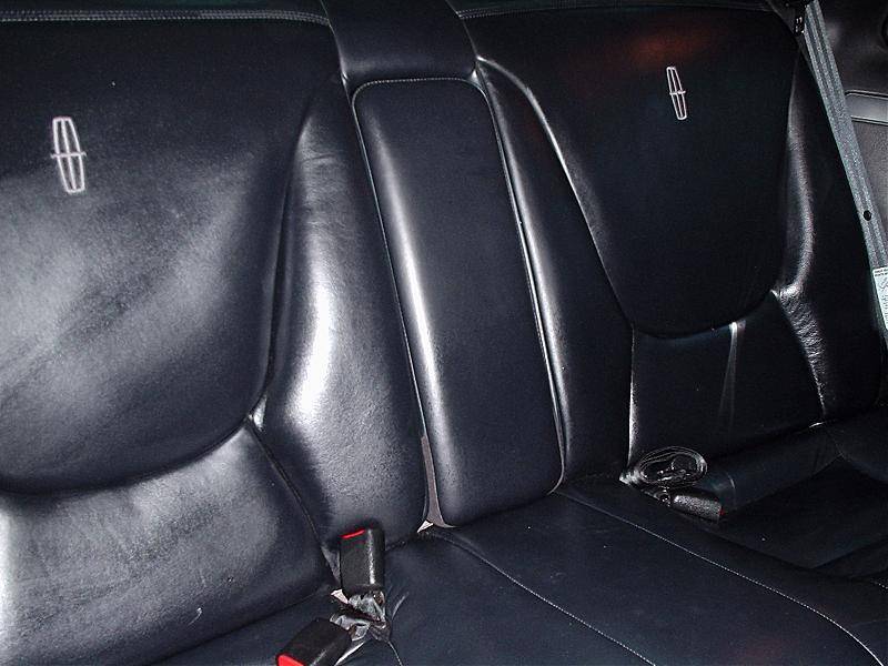

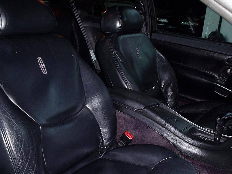

yup, just roll the leather up off the gen II seats, do the same for the gen I and swap the foam and reinstalll gen II leather. I have to do another one, I will be sure to do a write up on it.
Markviiiedera that interior looks great. Makes me want to forget about the maintence items I need and convert my interior to black lol.
