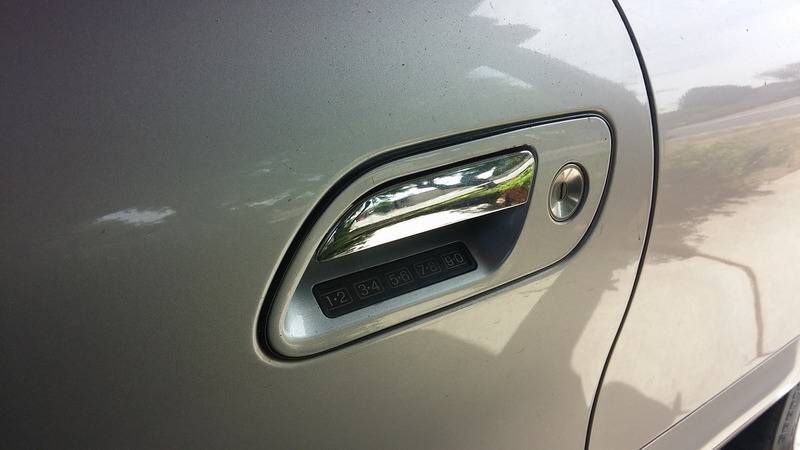

    Seems like once I fix something, another goes wrong. I went to open my drivers side door, and the handle towards the front snapped off. It's still connected but it's broken, and hanging there. Is there anyway I can have the original door handle fixed? Or do I have to purchase a whole new assembly? Thanks, y'all.

    Can't be repaired as in nobody will/can weld pot metal
    You can replace just the handle.

    a chrome one from a continental.
    plus the opalescent was a pretty popular color, not terribly hard to find white handles.

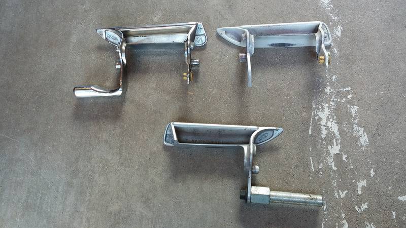

    It is easy to install them, you have to be careful to not gouge the door with all the sharp parts of the cup.
    I have pulled a number of them from cars in the you pull it place. I went with chrome for now but since I have cans of touch up paint for my slightly easier than tri coat color of Silver Frost I will probably paint a couple up to install next time I decide to tear into the car.
    There seem to be a couple of different styles, the newer Continental ones seem better, but still see plenty of them broken. The chrome ones with the integral weight seem better, they don't have quite as narrow of a place where they seem to break.

    That's at the higher end of the pricing spectrum imho. I'd buy a pair of conti handles at the local yard for $20 ($50~ on ebay) and transfer them onto your existing base/bezel. .02
    Grab a flashlight and peek in through the outside to see which one broke.
    Replacing just the handle requires removing the whole assembly, remove 2 little retainers on the pins and 2 "springs". A little tricky for a first timer but can be done with a flathead and pliers. Not difficult, just tricky.
