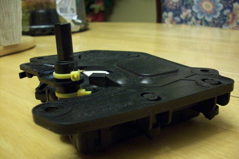

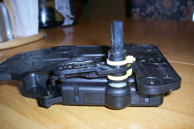

The reason the blend door fails is because the plastic shaft breaks or cracks and wont rotate. The blend door module itself is usually not the problem. When I had my 97 I had to replace the blend door. I took my broke one and fixed it. Here are some pics.
new ones are redesigned and dont break and only cost 30 bucks. to go through the trouble of taking half the car apart, to temporarily fix a broken one is a waste in my opinion, for 30 bucks you can fix it right and for good!!
