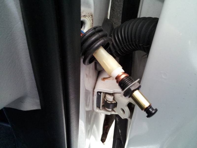

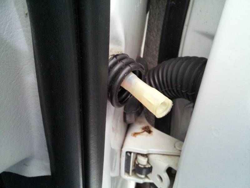

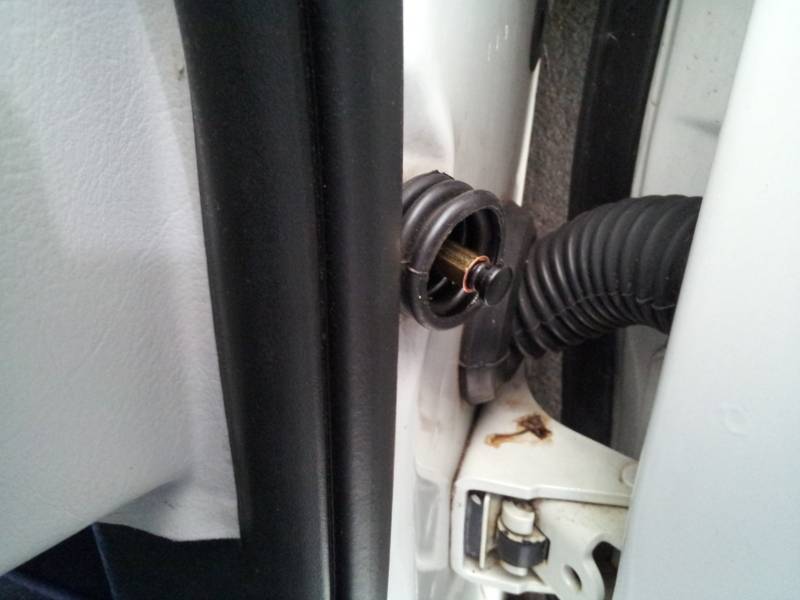

Go to rockauto and order some new door jamb switches. They're about $3 or $4 each and ship fast. Takes30 seconds each to swap.
Screw the new switch in and tighten. 9/16 or 15mm deep well socket works. I replaced both of my switches a few months back and all the crazy problems I was having ended with just the drivers side but I done both because they were simple and cheap. Get Motorcraft
No, this doesn't apply to any 97-98 cars, as they have a side specific switches built into the latch mechanism.
Gotchya, no wonder I don't own one!I see something everyday that just turns me away from the Gen 2. Issue after issue...
Unfortunately this is not only a G2 issue.
You car has the same switch inside the latch, and it triggers the door ajar message.
The switch you replaced is a domelight/alarm trigger switch.
In 97 they got rid of it, and incorporated the theater lightning into SCIL.
