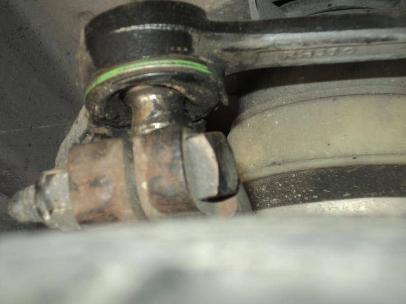

heres a good pic of the passenger side front wheel arm/joint.
do you think it will last a couple of weeks like this? No boot n all?
If it's not making noise yet, like creaking/grinding, then you'll likely be OK for a little while. That being said, I wouldn't let it go any longer than you NEED to. Make that your next priority.
Think of what could happen if it goes bad while your driving? If their that bad, chances are the rest of the front end could be as bad.
You test by moving arm up and down at joint to feel for play/looseness. If the joint is tight,it will go while. Just looks real ugly with no boots. You can go get couple boots cheap to go on there to make last longer. When you disconnect them to put new boots on you will really be able to feel any play.
my advice, take it or leave it: unless you KNOW some of the front end was replaced less than 50k miles ago, plan to replace everything on the front end all at the same time: (UCAs, LCAs, tie rod ends, sway bar endlinks, SRBs) if you just do it as it becomes obviously worn out, you'll be working on the front end constantly
and...regardless of the temptation to 'save' money don't even consider buying used suspension components; you won't save money, you'll just do the work twice; I did and still need to replace one of the shocks
h o l y c r a p.... :eek: This sounds like it got into the four digit number money wise quickly. Would all of those pieces be easy to replace to a friend of mine who knows cars? Crystal clear on the ALL NEW PIECES got it thank you. I'm taking all advice dnsherrill, I would never leave it. Trust me when you guys post back I hit the thank you button as hard as I can because I plan on driving this little guy to school in the future, when I feel its safe enough.
Park the car, and get both replaced. I have machined those components and would not repeat would not be driving around with those joints.
