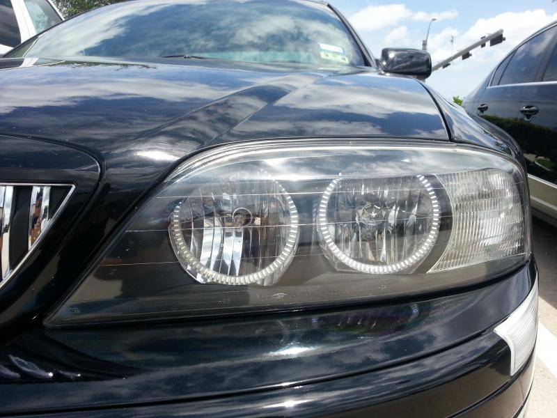

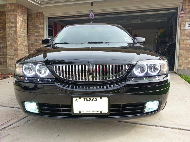

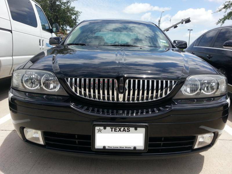

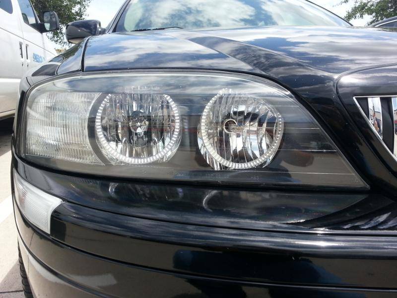

I didn't want to create another thread regarding the angel eyes. Well now after one year my angel eyes is so DIM and it flickers. It is the Umnitza Orion V2. I wired it directly to the battery, And the car stays in my garage. I only put approximately 3,000 miles on it for the last year. what could be the issues? Pictures below are the before and after.
Before: IMG_20130524_170813.jpg
After: 20130614_143638.jpg20130614_143616.jpg20130614_143622.jpg
Haven't seen them fail like that before. Its weird that it happened to all of them, the exact same way. What have you done to check them?
check the bends in the wiring, mine were good until I tried cleaning up the wires by folding, zip tying, and tucking. Then I tried them and they did kinda same thing as yours. apparently i broke a wire when bending.
I checked the wiring from the battery all the way to engine bay at first and did not see anything wrong, no exposed wires that are touching the body, but from what G-RELL said below I started moving the wires from the white ballast and the angel eyes went lit and bright again.
Well I found the culprit, as I said above, and discovered one wire is bent and pinched, no exposed wire. I straightened it up and Bamn! angel eyes are lit and bright.
Thanks ALAX7 and G-RELL for the help... :cool:
Good to hear man... Yeah I had just installed a new ballast for mine, $6 on ebay, and it worked perfectly, cleaned up the wiring and same thing (went dim on me).. Undid the wiring, and back to normal.... must be some brittle wires in these?
