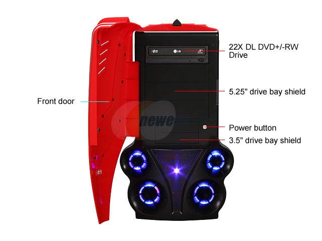

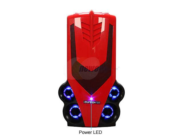

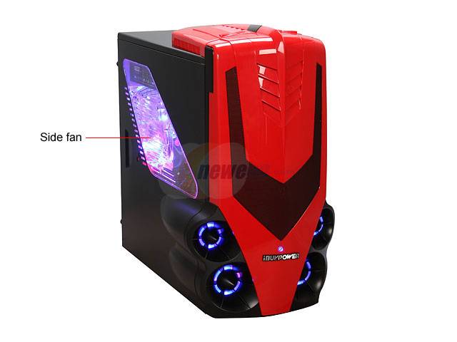

I actually am gonna be custom building my own from the ground up but I'm deciding all my parts but I'm pursueing an Intel 4 Quad Processor with a Geforce 9800 GTX graphic card, 5-8GB of ram, 850watts of power, multiple rip drivers, hybrid cooling system, internal surge protection, and not to mention this pretty sweet case
But in silver instead of red so it can match my LS nicely :-D
Just one of my choices. I want a PC that will stand out :-D
These towers even come with neon cathode lighting
If I had money to spend on some Government code hacking computer Id spend it on my cars instead.. Just saying, I like my laptop..
