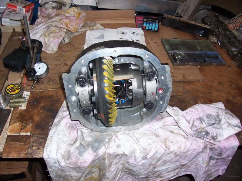

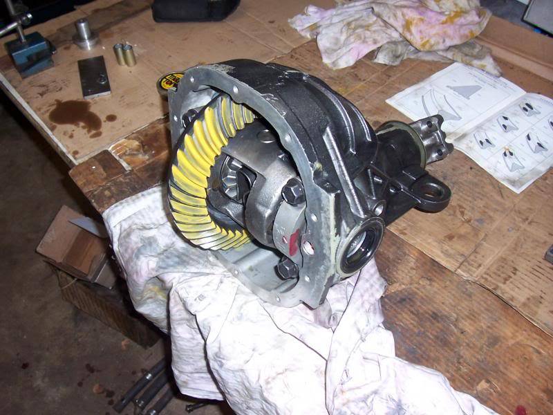

Man I hate doing them. So much crap to do them right. All new bearings, seals,FMS 3.55 gears and FMS 31 spline diff and a GM front yoke. Had to machine case to accept GTO braces.
So ya wanna do my 4:10s, is that what you're saying?
Eric, it's not bad. Mag base dial indicator, press/bearing puller, lbin torque wrench and a case spreader (I made one). There are also some Rotunda pieces that help too that come up on Ebay from time to time.
Jesse, GTO owners have a kit to use the MN12/FN10 rear housing.
