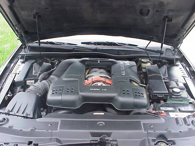

Before detailing:
After detailing:
you need a new crossover pipe, take it off and powder coat that thing, the rest of your motor looks superb but that pipe

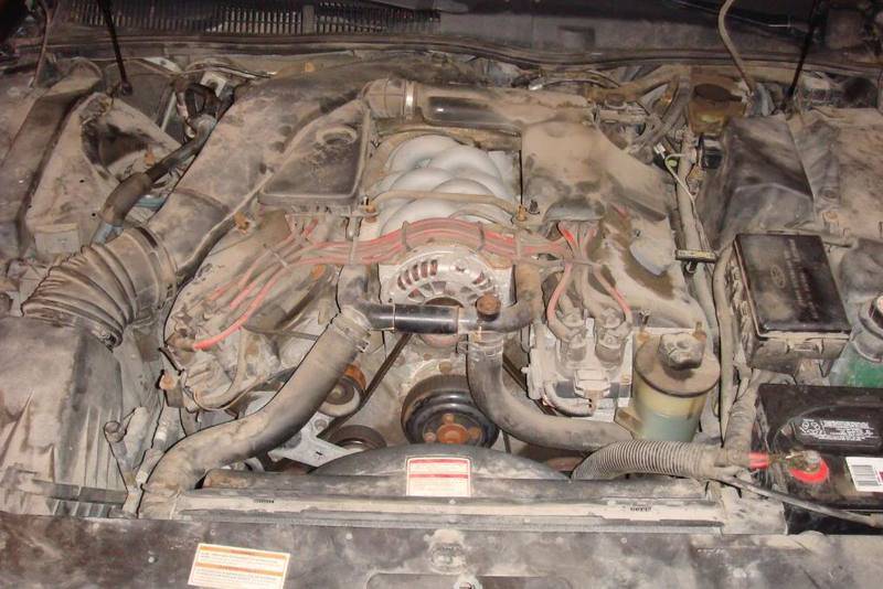

Before :eek::

Yes, it is the same engine comprtment :cool:

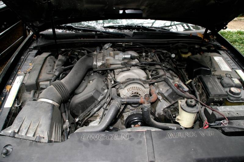

Before :eek::
After finish detail:
