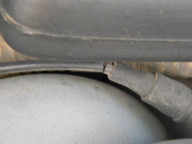

Found another problem, searched for a cure but found nothing. My Mark recently sat for 4 years and I probably had the defroster on when I parked it. Now it's stuck in the defrost position, it still goes from heat to air but only through the defroster. You guy's ever hear of this? Maybe something I can lube or ?? My air needs charged but don't want to do this until I can get the vent to change.
Vac leak in the black hose running across Plenum into passenger side firewall
Can you elaborate more please! Vac hose runs across motor and into the fire wall behind glove box?
Just tested out control and this is what I found out with the controls.
Stuck on defrost.
Blows a little cold through the defrost (it's hot out today and ac is definitely getting cold).
Compressor kicks on for 3 secs then off for 4 secs then repeats.
Tried every setting and only defrost works.
Cold line gets cold, hot line gets hot.
Good thing is it seems to be getting cold...needs just a charge right?
1st time I tried the controls since I started working on it about a month ago.
the vac line under the hood over the intake plenum, get weak after years of heat underhood, find the leak,, cure the problem
The line runs into the passengers side fender. If the fender is removed, you'll see a black canister about 8" or so long, maybe less and it could have come loose inside there but don't go removing the fender until you have checked that black vac line from the fender, across the plenum and back as far as it will go. If it all looks good, keep switching back and forth from Heat to Max AC. If that doesn't help, pull out the EATC unit and make sure all lines are connected on the back. If everything is good there, then you might have to remove the hood and fender and you will see the black vacuum canister setting there and the black line should be connected to it.
Check ALL those thin plastic vac hoses...bet their brittle as well as their couplers
Its Going to your defrost as a default for having a vac leak, this is a safety feature so you can still see out of the windshield
If you can't take a vac hose and wrap it around you're hand, replace it

Now that's where I'm at. If you have been removing and installing the beauty cover, I'm thinking you have broke and or pinched a line. One coming loose inside the fender would only be on a rare occasion. Not really inside the fender but it's behind it. Now that you see just how little that line is, carefully trace it. This could also be the blend door actuator being stuck, since it did just sit for 4 years. Like I said before, make the fender removal the very last option because I have only heard of them coming loose in there maybe twice. I also wanna say that these people had removed hoods and fenders and one was pinched and the other needed the whole assembly that sets up there on the top of the fender well. If you haven't been taking off the fenders, it's unlikely that it would be in there so don't worry. Hopefully it's as simple as GMAN's line break.

You were right on GMAN! Right were you said it would be...all fixed and now all settings work!
On a side note, if you're the only one looking under the hood, I would just leave the beauty cover off. I know it hides a lot but it tends to get in the way more than looking pretty. The more heat it had to endure, the more brittle it's going to get and if you ever sell the car, you would want that part in the best condition as possible. I keep mine right above the garage in the attic because nobody but me ever looks under the hood. Let that ole 4.6 breathe. :)
I think this time it broke from sitting too long. fenders never been off and I am the only one that works on it, except for the up coming recall fix, and ac recharge. I've been reading all the old post too :) I think I'm losing sleep from spending to much time on LVC...lol But on the other hand I'm learning alot!!
Don'tchya just love it when things are a simple fix? :D I'm glad to see that's all it was and now that you know where it is, if you happen to do any work around that line, you'll know to be careful in that area.

For example...It took me an hour to fix that Vac line! 55 minutes to figure out the camera/take a pic and 5 minutes to fix line :) I'm still a little technology stupid! The kids been helping with taking pics for me and downloading into computer. The Vac line pic...I was on my own...that's probably why it was a little fuzzy...lol
