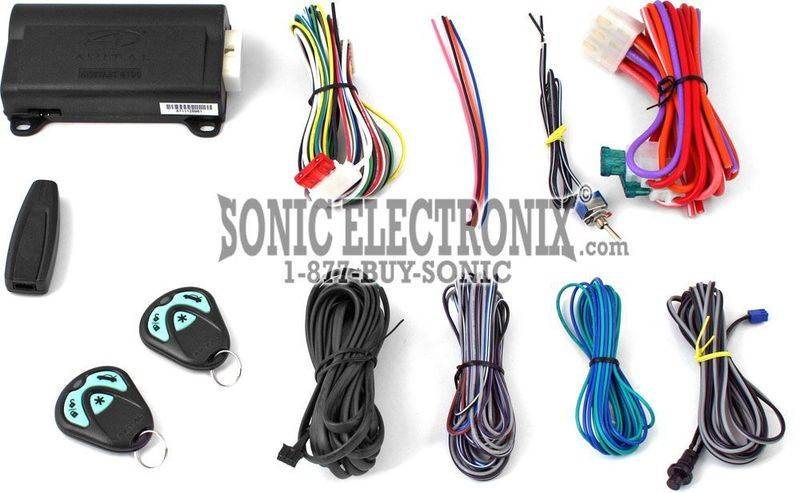

The system looks like an Avital 4100, so it is probably crappy already. The FOB looks pretty outdated. It looks like this:

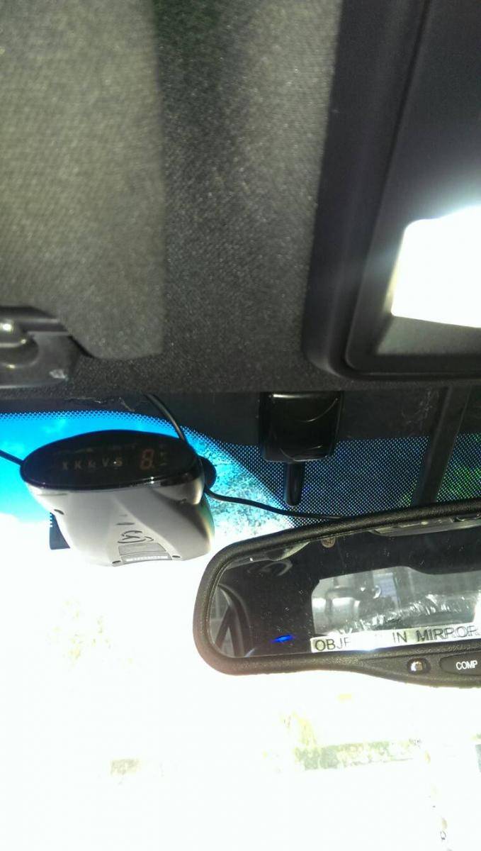

So where do you guys have your antennas mounted for best reception? I have tried near sunroof and near mirror, but get mixed results. I do have tint on all of my windows, including windshield. However, above the mirror there is no tint, but the factory windshield tint/strip is present.
So I wasn't sure where to get best results.
the antenna usually go at the top of the windshield pointing down just like LSEMEX's
I would pull up the manual on that system, vipers newest models of the same series are almost exactly the same (like the 4105/4115), depending on when it was built, at some point they started adding a "ESP2" data port or a "bitwritter" port. its either a three pin black connector or a four pin red connector. if it does support ESP2, then you could always add a Viper Smart Module (like the VSM200) and control the car from anywhere in the world (that has cell data service). talk about serious range.
those are also their weakest remotes as far as range, first check with brand new batteries (when replacing the batteries, check the connection on the battery terminal where it contacts the board, they are notorious for cracking and needing a little solder), and then you could alway buy a new/different remote and antenna set with better freq and range (you would have to do a little looking in to it, not every antenna and remote set are interchangeable).
also is it set to start the car from one push, two pushes, or pressing two buttons at the same time? programming it for one press activation usually get a good bit of range more.
Thanks, I will relocate the antenna to above mirror.
I have looked online and from what I gather, it looks like there is no upgrade fob for this one.
