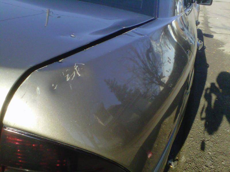

Your keyhole is here. between the rear surround and passenger rear tail light lens:

Your LS was designed with a mechanical key lock access for the trunk. It uses the same key and the door and the ignition. It's on the back of the trunk lid, on the right.
All LSes (100% of them, gen I and gen II) came with mechanical key access to the trunk. If yours really doesn't have one, then it's because you or a previous owner removed it.
