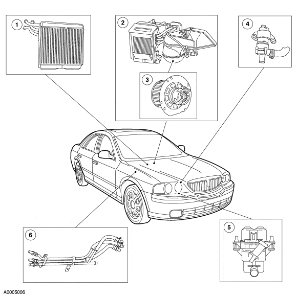

Also, are the DCCVs universal from year to year, or do I need one specific to an 06 LS?
--when i run the self test on the HVAC I get code 27 98
While it could be the DATC or wiring, it is 99% likely that your DCCV is bad. That code normally comes up when the DCCV leaks into its solenoid coils and starts to short them out. It may or may not also blow the DCCV/AC clutch fuse.
There are two different types of the DCCV, one with three hose connections and one with five. You should have the three connection type. I think the difference is between gen I and gen II. Certainly, any DCCV made for an 03 to 06 V8 will work.
Hi, I ran the self test and got codes 27 99 and 27 97. Any ideas of what those mean? Thanks in advance
Both of the solenoids on the DCCV are reading open circuit. Either the DCCV is unplugged, the wires are cut, or (and most likely) the coils have corroded and the DCCV needs to be replaced.
Thanks for responding so quick -Could it be a fuse? It was working fine-then heat blasting out of both sides
Joegr-do you have a pic of the dvcc so I can try to unplug it? Mine is an 06. I'm pretty handy and can do small jobs. I want to do that test from page one on the fuse/dvcc connection
To unplug the DCCV connector is to simulate full heat, which you already have coming from the vents as you stated.

CAREFULL, different P/N's on the DCCV for both GEN's!!!
1st GEN = 5 in/outlet tubes.
2nd GEN = 3
correct me if I'm wrong, I didn't double check, only recall from when I redid my whole cooling system.

Bunch o' pics for ya from Google ... lincoln ls dual coolant control valve
by unplugging the DCCV, you are doing the same as cranking the max heat setting to 90F.

You're correct- I obviously found it and there is 3. I found the fuse ( no fuse chart on underside of cover!?) and it was blown. I didn't have a 10 amp, so I put a 7.5 in the slot and.....nothing. Still got hot air blasting out. I also ran another code run and got 27+ 97 98 99. I wanted to 'pinch' the hose to see of that worked but didn't know which one to pinch. Thanks again for looking that stuff up for me. I tried the search funciton but there was a lot of threads and didn't have an extra hour to look thru them all for the pics of it. Appreciate ya
I did read in one of the threads I searched here that some guy 'rapped it' with a small hammer to get the solenoid to engage? lol-doing my best not to spend money!
