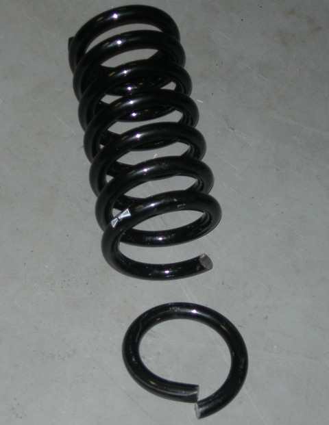

anyone have pics of say "half a coil" cut off with before and after pics of the spring itself. im assuming that wherever the spring ends on the top, go directly acorss from the end on the next coild down and cut...
don't cut "one coil down" just take the end of the coil and make a cut straight across.
here is just a pic from google. this is considered cutting 1 coil. cut only half that much off at first.
this is 3/4 of a coil cut off
you get the idea, but only do 1/2 a coil. 1/2 coil put you right at 1 inch lower.
