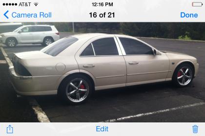

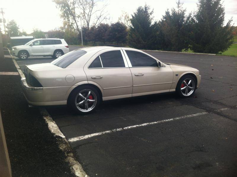

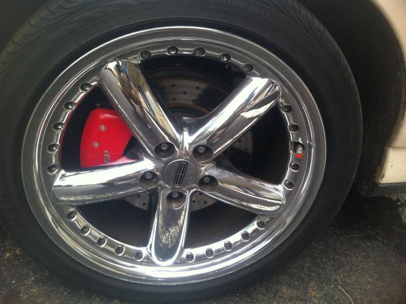

Hi guys...new to the forum. If this is not the place to meet and greet, feel free to chastise me and send me to the right area..love the forum..and Mlara is the best all around...please give feedback on my Linc..take care to all.
Damn dude, you got it like that???!
Welcome, please post your pics and all in the pic thread... I like the car (and the color obviously) just wish you'd get rid of the chrome, but hey its your car!
Yep..Coventrys..in mint condition bought off of CL for $200 plus shipping..a steal huh..
