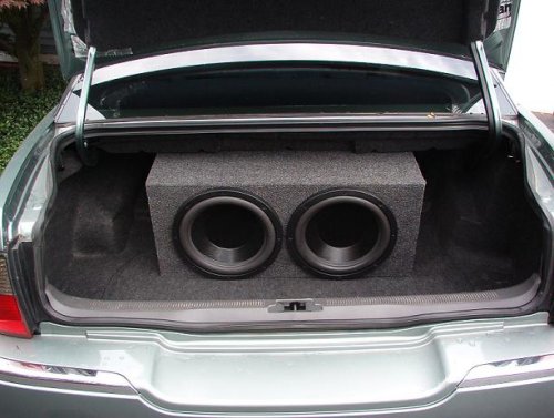

Can you guys post pics of your custom trunk set ups? I'm in the process of turning the car into a show car, and i'm planning on doing a custom trunk set up, and i'm looking for ideas. I'm thinking of a custom ported box, but i am having trouble building it around the arms that drop in for the trunk. wehn you post pics of your set ups please post pics of what you did to incorperate the arms of the trunk.
This is a pic of what i have now

You can build a beauty board/cover board that has holes cut in it that allow the support arms to tuck nicely in when you close the lid. You can even get an acutator brush to cover the opening from the backside but still allow the arms to tuck in. It just cleans it up nicely.
ya i started working on it tonight, i still have to wait for my new amps to come in though so it will be a litle delayed. trying to fit a ported box into the trunk, but i cant with out losing all cargo space, or what little i have now. i should be done in a few weeks
What kind of ported box are you talking about? You should be able to fit almost any type of box in the car.
a 4 cu.ft ported box tuned to 35 hz. The biggests ported box i could use would be around 3 cu.t ft and still be resonably large. I dont want to use the whole trunk.
Made the box a lil shorter than the arms, and make the cover all the way to the edge and just cut a lil space for the trunk arms to move.

last pic is the original set-up. thats as far as the sub box would fit in the trunk so i had to do something about it. the first pic is the same box as the last pic but i put it in the spare tire well. basically replicated the false trunk floor with some ply wood and sprayed spray on glue and covered it with some fleece. gotta be able to fit the surfboard in there.
