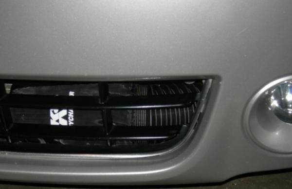

Custom CAI
no heat soak down here.
Does that ribbed plastic tube do anything to the air flow?
No, there is only about 18 inches of that ribbed tubing with the angles I had to get around. The rest going all the way to the throttle body is 4" smooth piping. The 3" that fit through the stock hole under the air box choked the car at higher RPM's. I dremeled out the hole to fit 4" piping.
